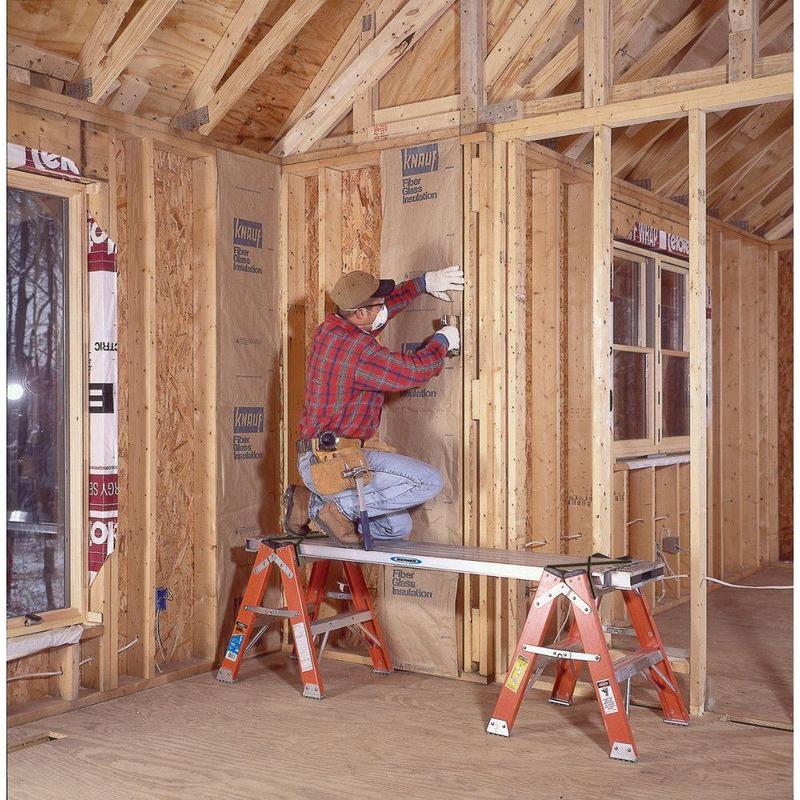

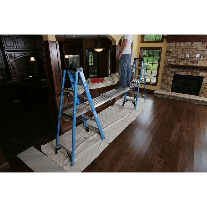

phototec
I like the fact that the Extension Plank is only 8' long for transport don't want to lug around a 16' 2"x12', and the Extension Plank is 14" wide not 11.25" like a 2"x12".
And the fact that I can make it any length I need in just seconds from 8' to 13' is very handy indeed. There are many, many uses for the Extension Plank.
Oh, and it doesn't take any longer to get a Extension Plank than a 2x12 at Home Depot, they are just a one isle apart in my store.

I agree the 2x12 would be a pain to transport but we don't do that, and we already had it in our shop from something else when we needed it. Definitely for any on site jobs in the future we will be looking at the Werner extension!
