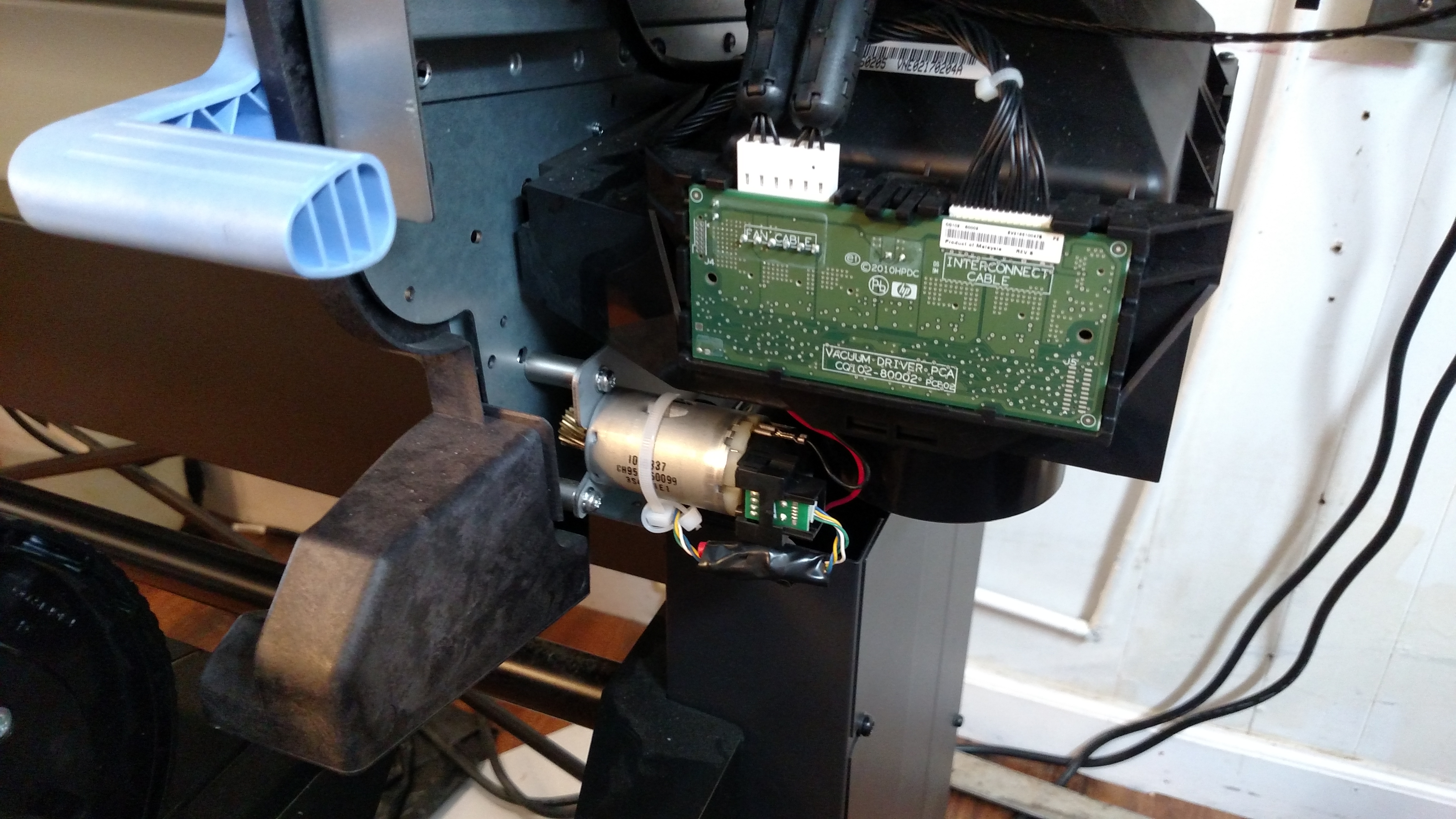

I have some technical experience in the electrical/electronics troubleshooting, thank God. I watched it throw this hard stop code several times on startup with this "input feed roller/rewinder" motor trying to rotate forward and then backwards real quick and stop (hunting), throwing this code.

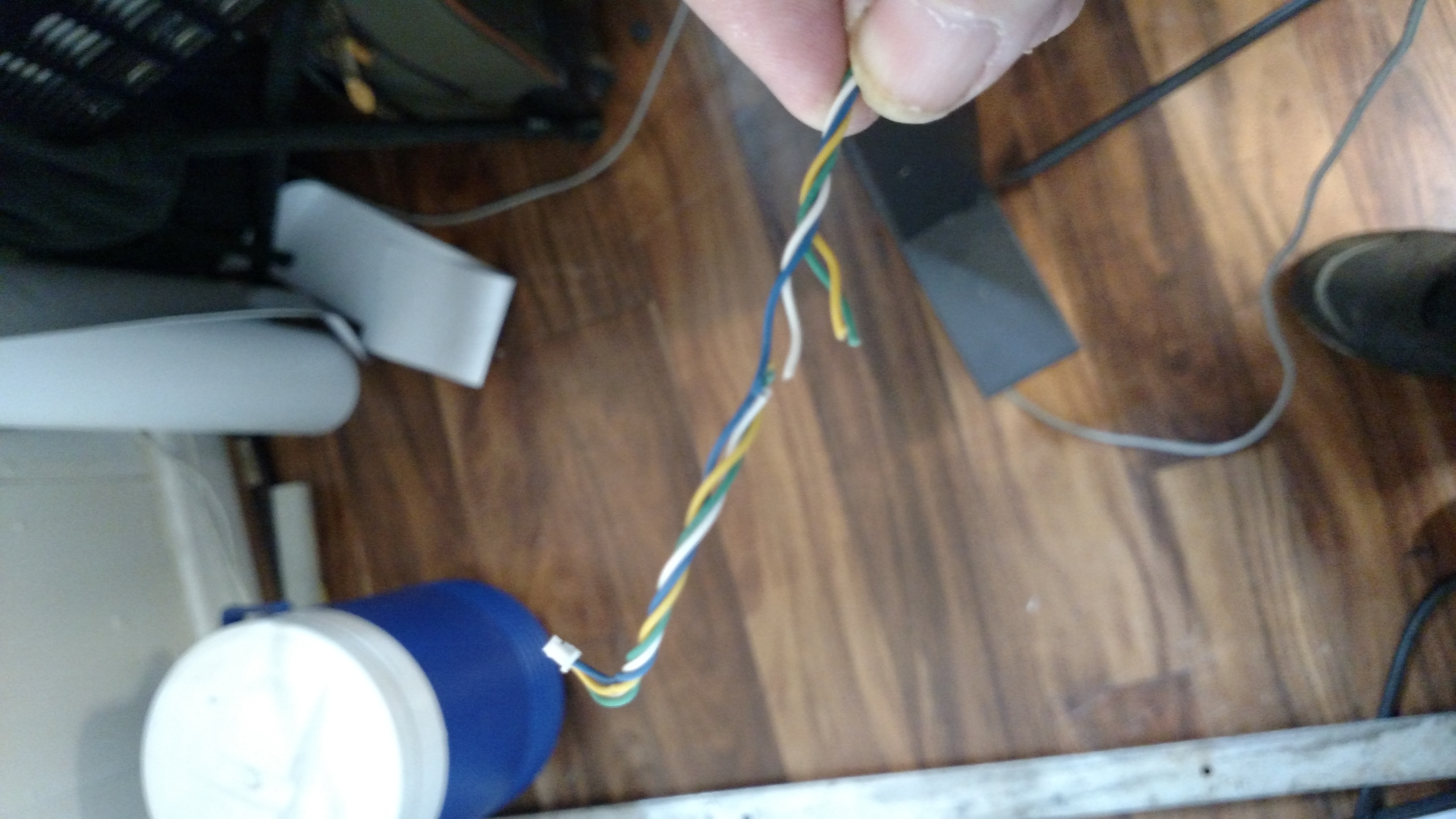

Taking the right cover off to inspect this motor there is a 4 conductor cable going to this little encoder on the back of the rewinder motor. The encoder on this rewinder motor gives the printer feedback to the movement/position of this motor. Checking the wiring on the back of the encoder, I found 3 of the 4 wire had broken off.
The vacuum blower is right above this encoder so it gives off a lot of air and vibration which led to the breakage. Fixed the wires and rerouted the cable away from the vacuum blower. Fixed!!!
