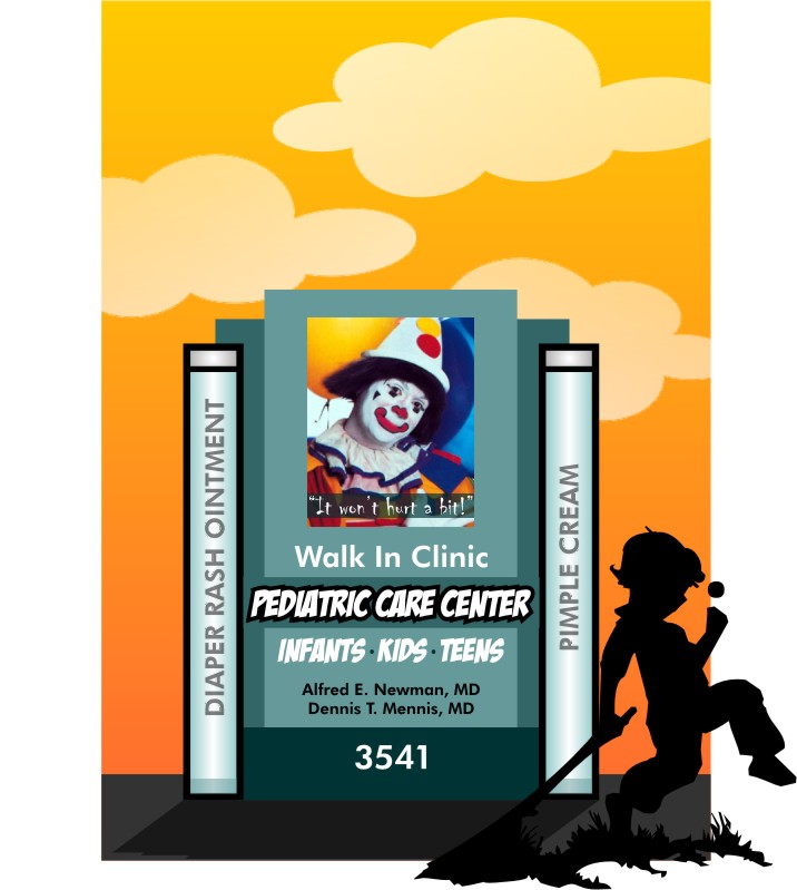

Here are 2 more from rejected presentations...
30 minutes for both... Illustrator/CadTools

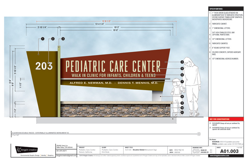

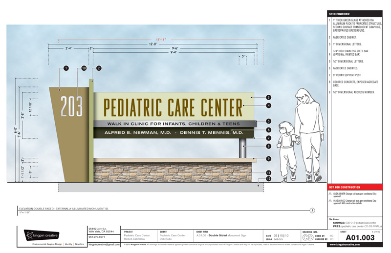

Rick
Rick, how do you get your spec circles solid black with CadTools?
Do you change each label individually after you've placed them?
On presentation drawings I don't use CadTools labels because I like solid fills on the presentation drawings, since most of the initial presentations are placed in the environment (or I fake one) Underneath the labels, there is another with a thicker white stroke to cut through color backgrounds.
I occasionally use solid fills on detail drawings because sometimes there are a lot of intersecting lines. The solid fills sometimes makes it easier to decipher the labels/notes.

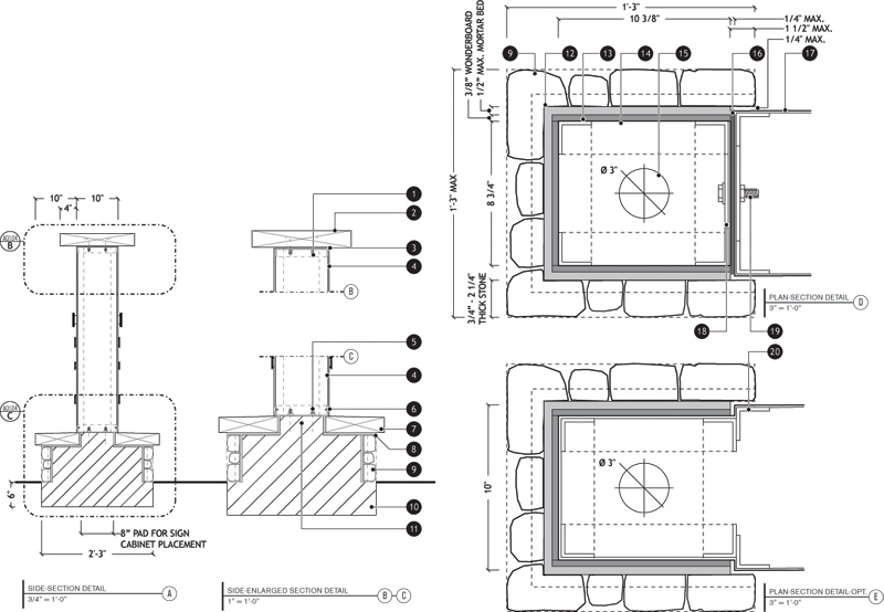

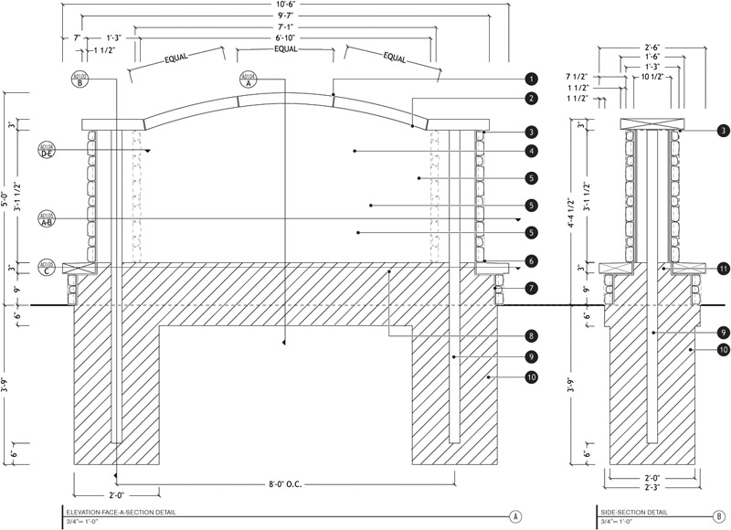

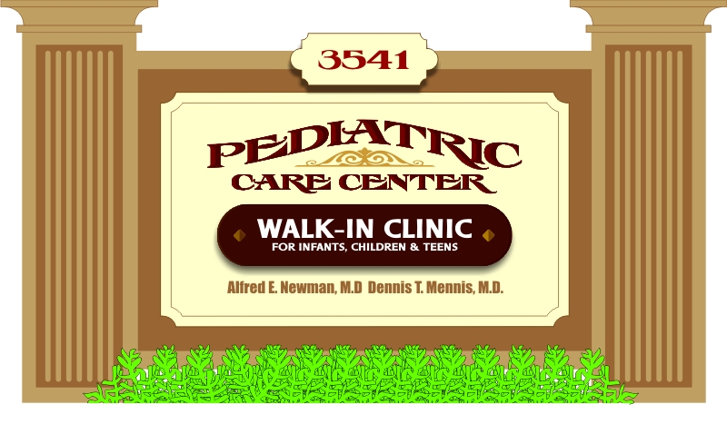

SignManiac
Here's one more from scratch. 35 minutes with tweaks so far. Going for a more traditional look and feel.
