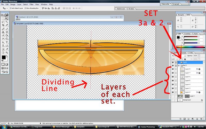

    I hope I can explain this in a way that makes sense.
    I have a fill that is 7 layers.
    I want to duplicate it, then flip horizontally to butt it up to
    the original to make the image below.
    I linked the layers, then made a SET.
    Copied the SET and flipped it.
    Now, how do I combine the 2 SETS together and still keep the layers :help
    PS 7
    Thanks,
    Brad.

    Show the layers in the GROUP :)D) you want to move ... highlight the layers and drag them into the other group.
    Further, once you get them all sorted... you could select the image for the left layer, and the right layer, and then hit CTRL E to combine those to layers.
