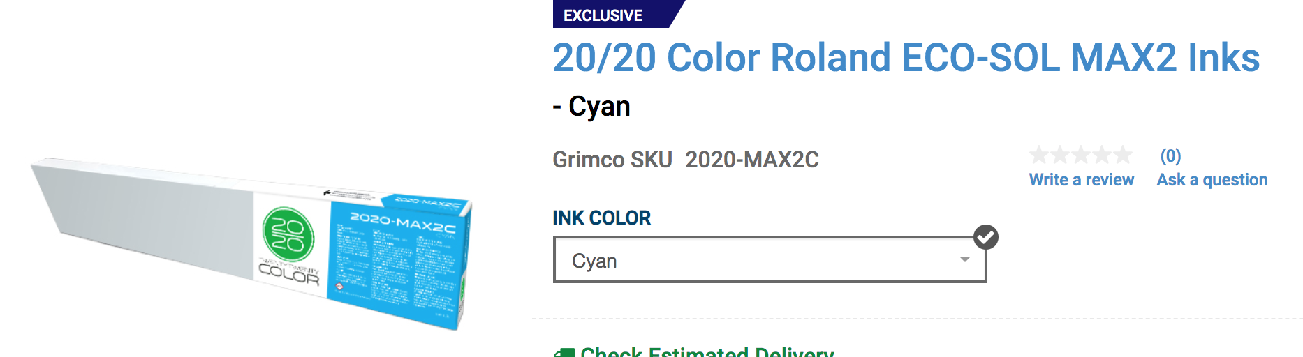

OK. Thank you I will try this. Attached is the type of ink I am using. I am assuming this is the CMYK MC type right? I am buying it for 85 bucks each
