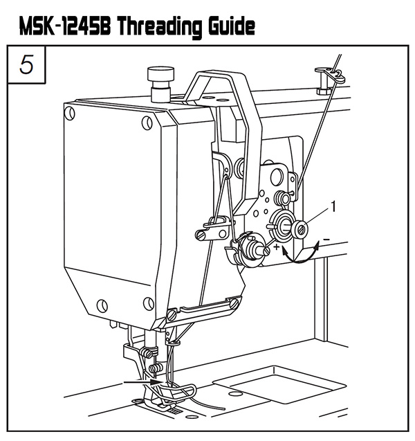

I followed the manual threading guide as good as I can, it's not very clear (see attached). The MSK-1245B seams to be a copy of the pfaff 1245, and I found a YouTube video showing how to thread the 1245.

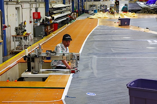

That makes it sound like the machine is fighting to pull the material through. It should pull the material through quite easily when it is going. If for example we have a big banner and some of the rolled up banner is hanging off the table then the machine is having to drag that back onto the table and it will do just as you mention, it will chew up the face of the banner with the lower feed dogs as they are fighting to pull all that extra weight up onto the table. To an extent that can also be an issue if the sewn material is simply dropping off the edge of the machines table onto the floor and there is a lot of material weight then trying to drag it forward through the machine. We drag a couple of tables over in front and behind the machines table to give the material a smooth, flat, level surface to lay one when it is feeding in and out of the machine. When sewing you do not want to fight the feeding, in other words you only want to gently steer and guide it, do not pull against it. Could also be that the feed dogs teeth are just very very sharp as well which could also cause some damage to the pvc coating on the banner. I also realize that depending on the size of the banner that having tables both in front of and behind the sewing machines table can be impractical in which case you might need to improvise some. We have for sure.... we have rearranged our shop at times and not had any way to get any tables positioned. In that case I've used a rolling cart, rolling stools, or a second person to help support the banner. Of course if the banner is beyond some sizes then its going to be impractical to have tables long enough no matter what. We have done some 50 footers - in that case no way can I have 50 feet of tables both in front and behind the machine. Just have to then fold the long roll up a few times, start sewing, stop and unfold some more, start sewing again, stop and unfold some more, etc. Its a balancing act for sure.
Having a table setup like this would be fantastic but...... for 99.8% of sign shops this would not be a feasible setup at all just for sewing banners. Would make sewing huge banners a ton easier though. Pretty much the only place you will see a setup like this is a place that specializes in very large sewn things like sails. I've seen this sort even with no top side entry where the operator has to drop down in the hole around the machine and even where it is totally surrounded on all sides and the entire machine and operators seat and rotate. Those would be called a sewing pit or for the rotating ones a sewing turret.
