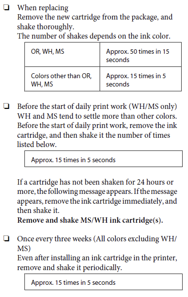

    Having just got my new printer and going through the user manual, it states that you should shake the cartridges on a monthly basis and the white, metallic and orange on a daily basis.

    I have an Epson. The silver and white cartridges have to be shaken daily. Takes 15 seconds. The other colors (including orange) it's every three weeks. There's a sticker on the printer that says to. If you don't do the silver and white the printer will remind you on the display. And if those inks settle, not only will they mess up the prints using those colors, it may clog the heads when it sucks the settled particulate.

    Rocking gently back and forth is best. Shaking can introduce microbubbles in the ink, which may take some time to completely dissipate. These microbubbles can travel to the printhead and cause nozzles to drop out, making you think you have some kind of parts problem, when it is just air bubbles. This knowledge comes from experiencing this because the customer shook the cartridge rather than rocking it.

    Sounds like a rather vigorous agitation to me with the amount of shakes per second.
    That being said, our machine will be 3 years old next month and we haven't missed any agitations. Just set up a calendar reminder for 9am every 3rd Monday and it gets done before anything starts production. Print quality has remained consistent the entire time. 2 minutes every 3 weeks isn't much to ask.

    We've had our Epson since the S series first came out, what 6-7 years ago? Shake the cartridges according to schedule vigorously and never had air bubble problems.
