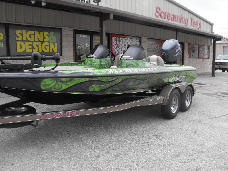

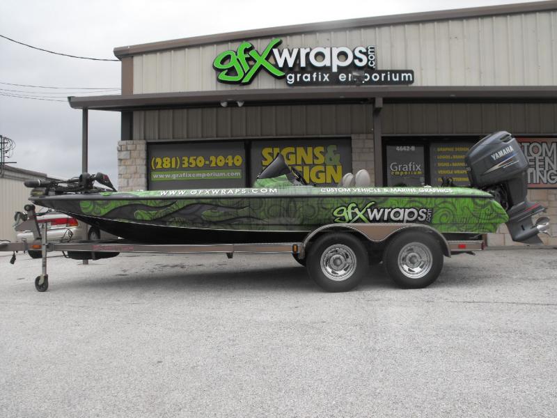

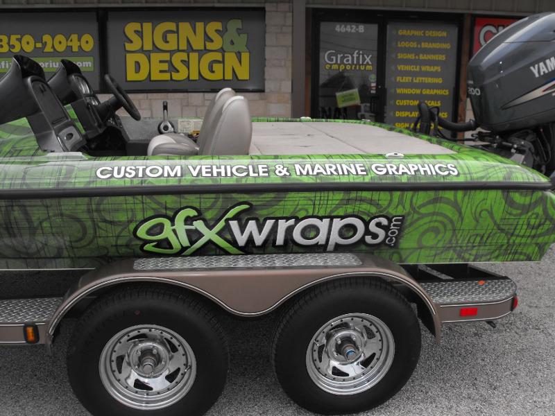

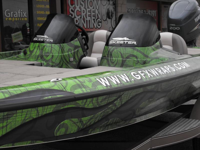

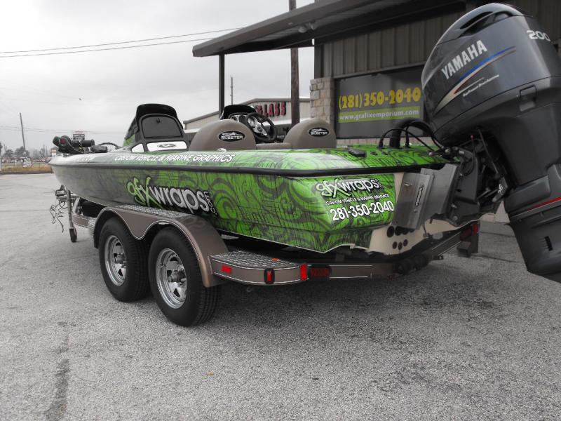

We just finished this Skeeter Bass Boat for a local pro bass angler. The deal was too good to pass up. Hopefully we'll get some visibility out of it.
We've done plenty of bay boats. This is our first bass boat... what a nightmare. Had to make a paper pattern for every little thing. Needless to say, our price on bass boats just went up :)

looks great! you guys do good work. did you wrap it on the trailer (dumb question i know, but we have acutally had to wrap a boat in the water)? if so, how did you wrap around the trailer wheel wells? we have wrapped a few on the trailer but they were jet fishing boats so the wheels didnt intrude as area being wrapped was up above.
grafixemporium
We've never had a problem in the past with bay boat trailers. The fenders have been bolted on every one, so we could removed them. However, on this bass boat the fenders were welded to the frame. We had to get creative and a little crazy.
Fortunately, we've got an marine aluminum fabricator across the parking lot from us. They do crazy things to boats all the time. We used their forklift and a tow strap to lift the back end of the boat by the hooks on the jack plate. We shoved two 4x4's under the boat on top of the planks it normally rests on. This raised it just enough to do what we needed to do.
