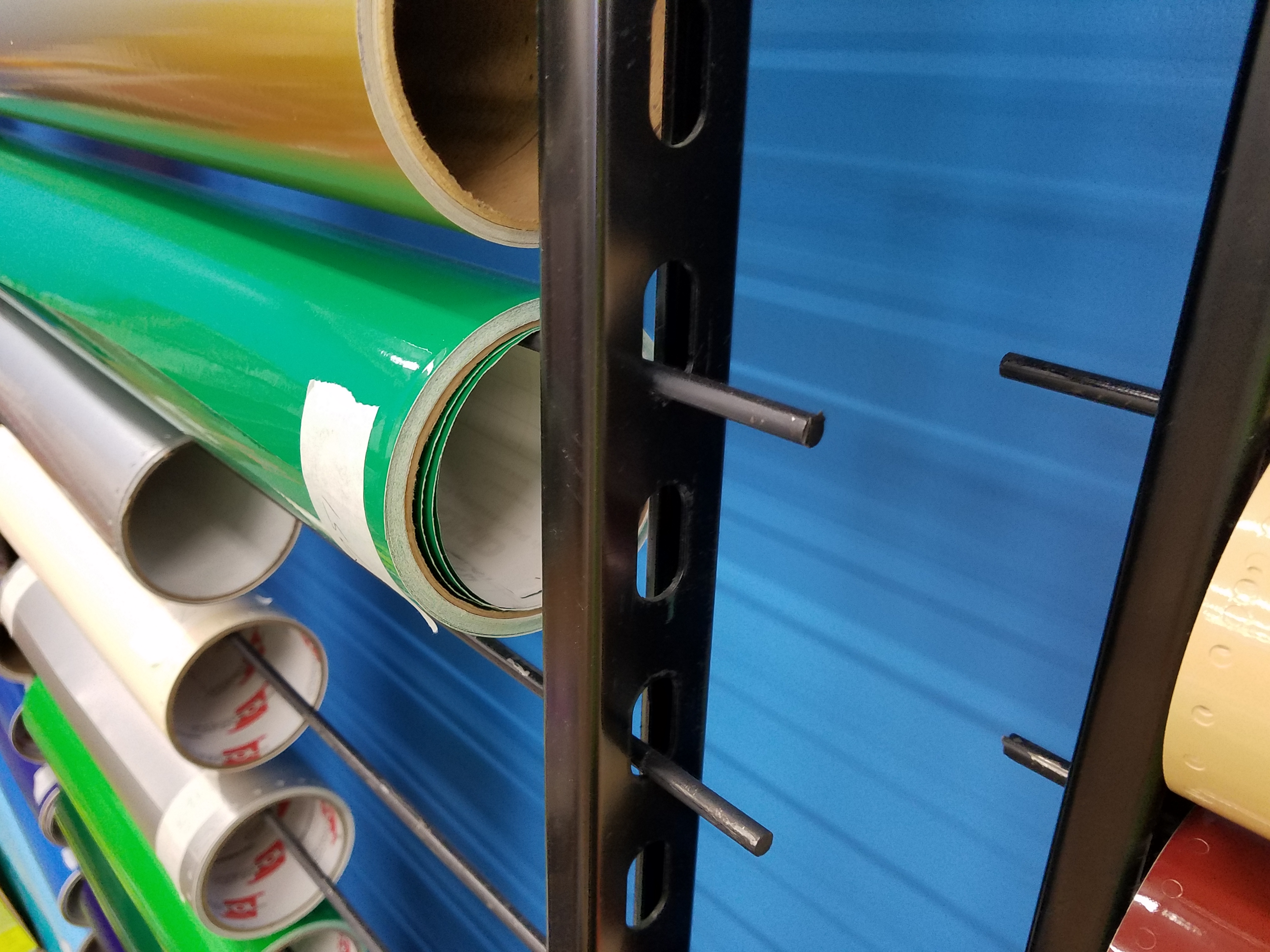

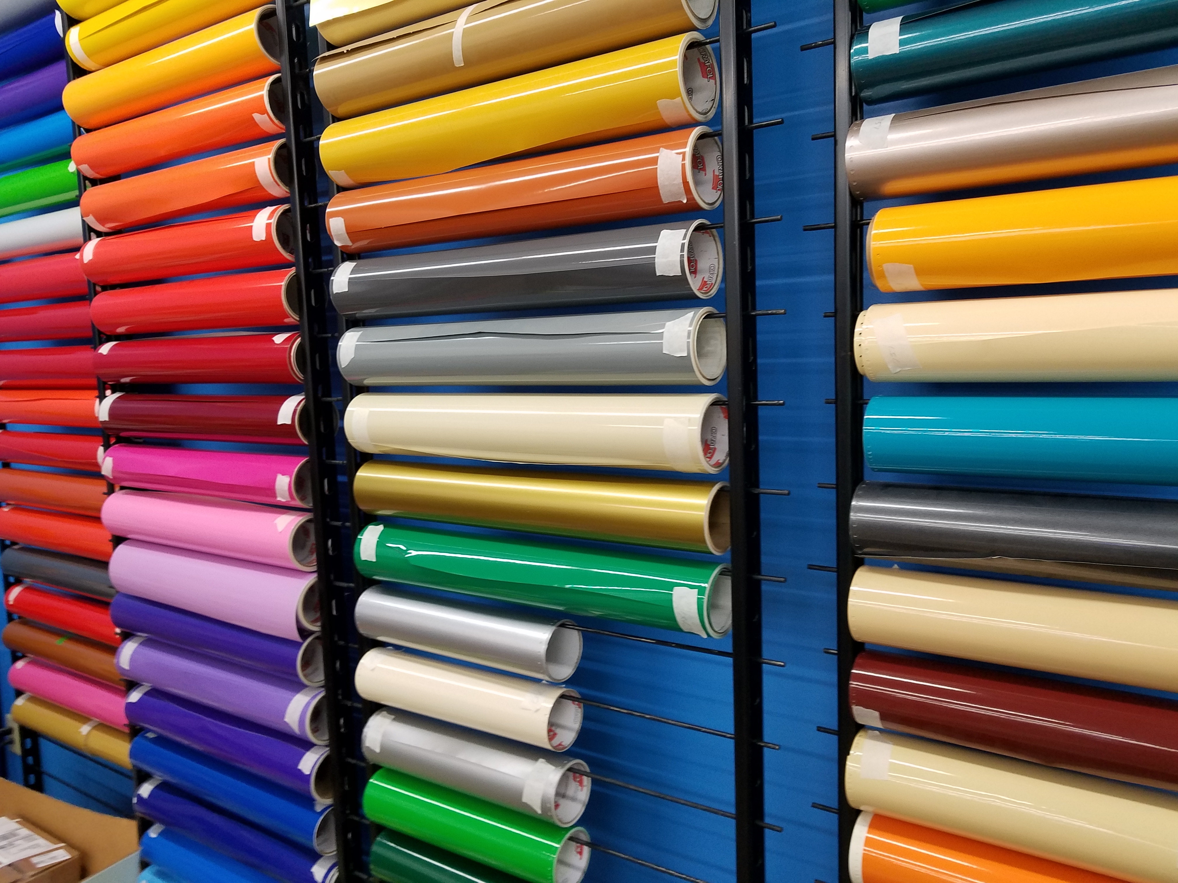

We stand up all of our print media and laminate, using the plastic plugs that come with the rolls to help keep them standing upright. We then cover them with plastic sleeves to keep dust away.
For colored vinyl, we built a rack using strut channels and 1/4" steel rod. We painted everything black to make it look more attractive. We have 4 racks that go from floor to ceiling and they hold a total of 96 rolls of vinyl. I think the racks cost a total of $300.00 and took maybe 4-6 hours to built, including the time to paint the struts and the 96 pieces of 30" steel rod.

I see a pink roll outta place ! ! ! ! ! :eek:
About once a year I try to reorganize everything and put colors in some sort of order just for aesthetics, but it doesn't stay that way for long. New rolls get introduced, old rolls get tossed, and it's a fair amount of work to relocate several rolls just to make room for one new roll.

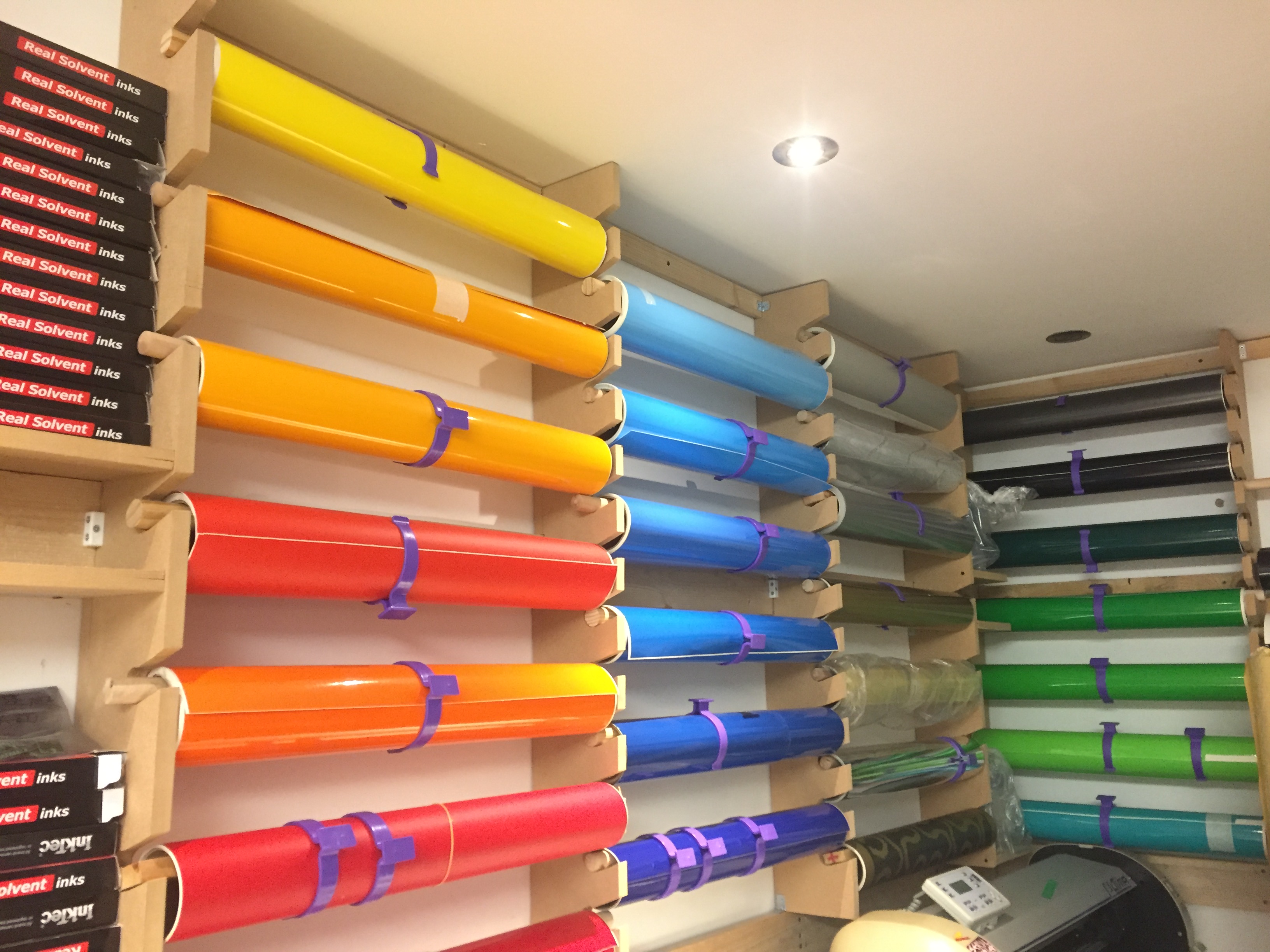

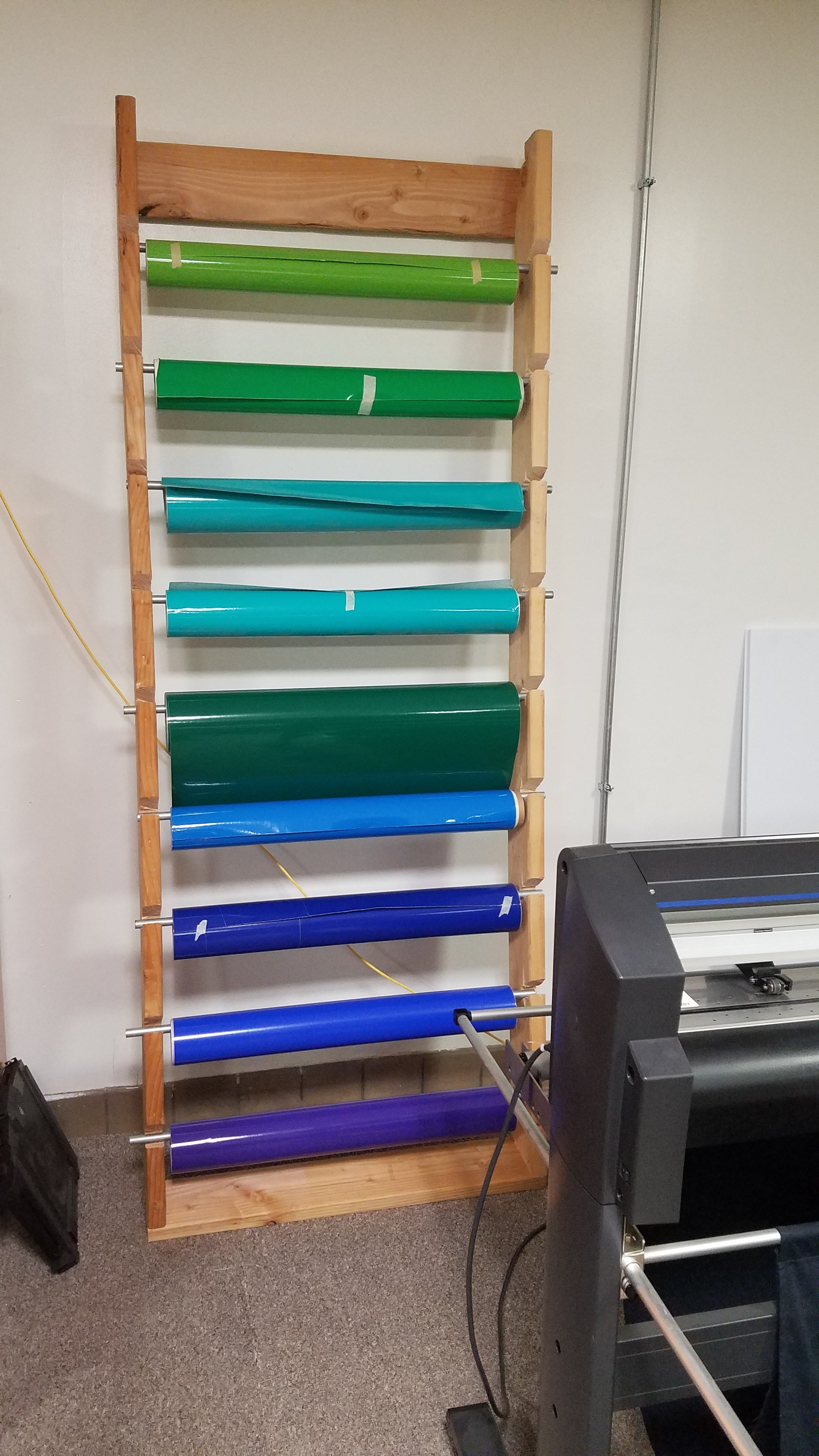

This is what I came up with for myself, I think this should work well, just need to make about 4 more. I try to keep some of the more popular colors in big rolls, and for print vinyl I have a bunch of different stuff in stock, I always try to have 1 or 2 rolls of 40c, translucent, a clear, and then a gloss and matte lam as well. I think it's time to clean house and throw away all these rolls with 10 feet or less on them. I try to keep one around in case my friends want some freebie stuff, they seem to love printing random stuff from time to time. o_O

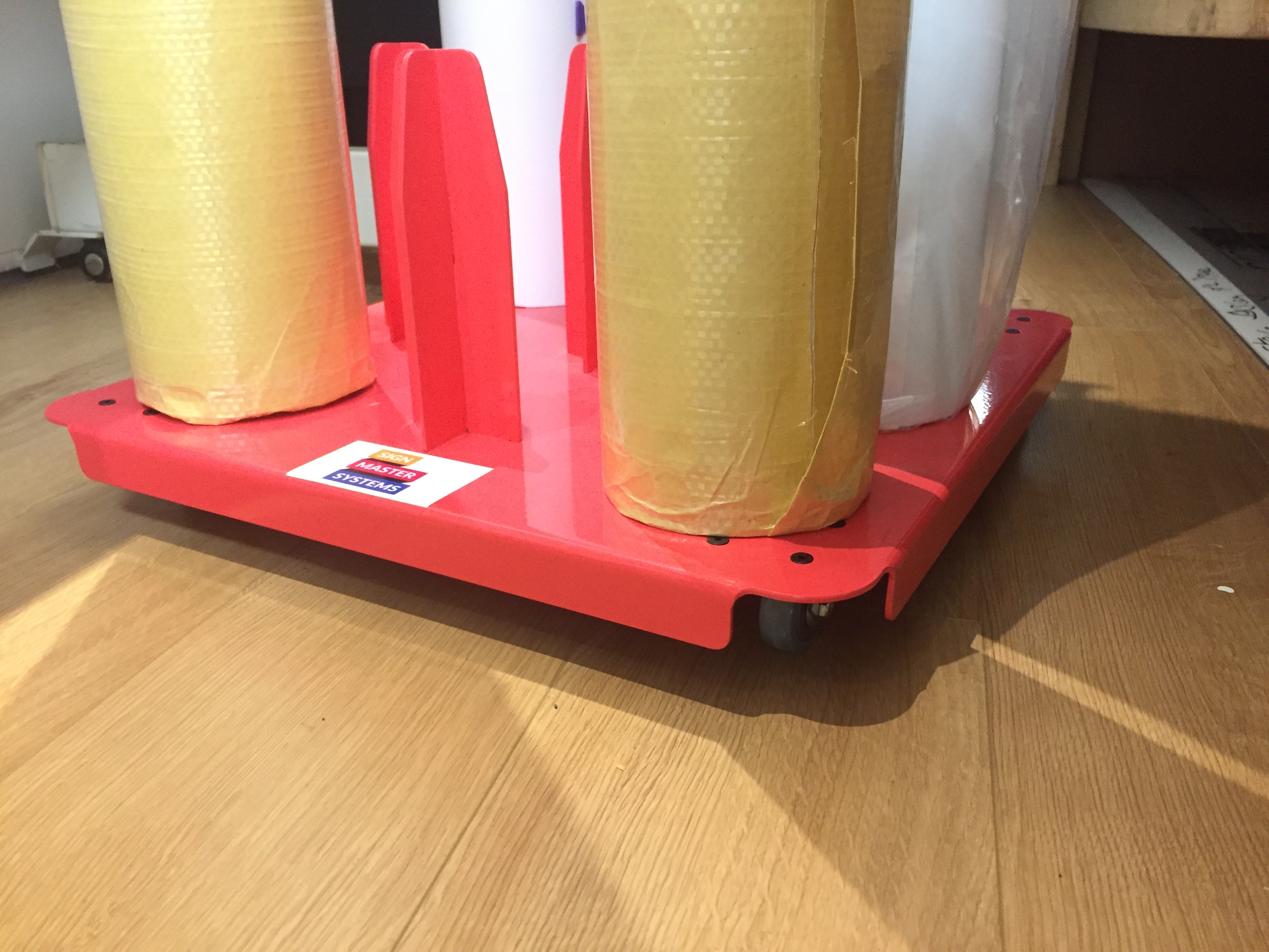

We build our own roll around carts, as well.

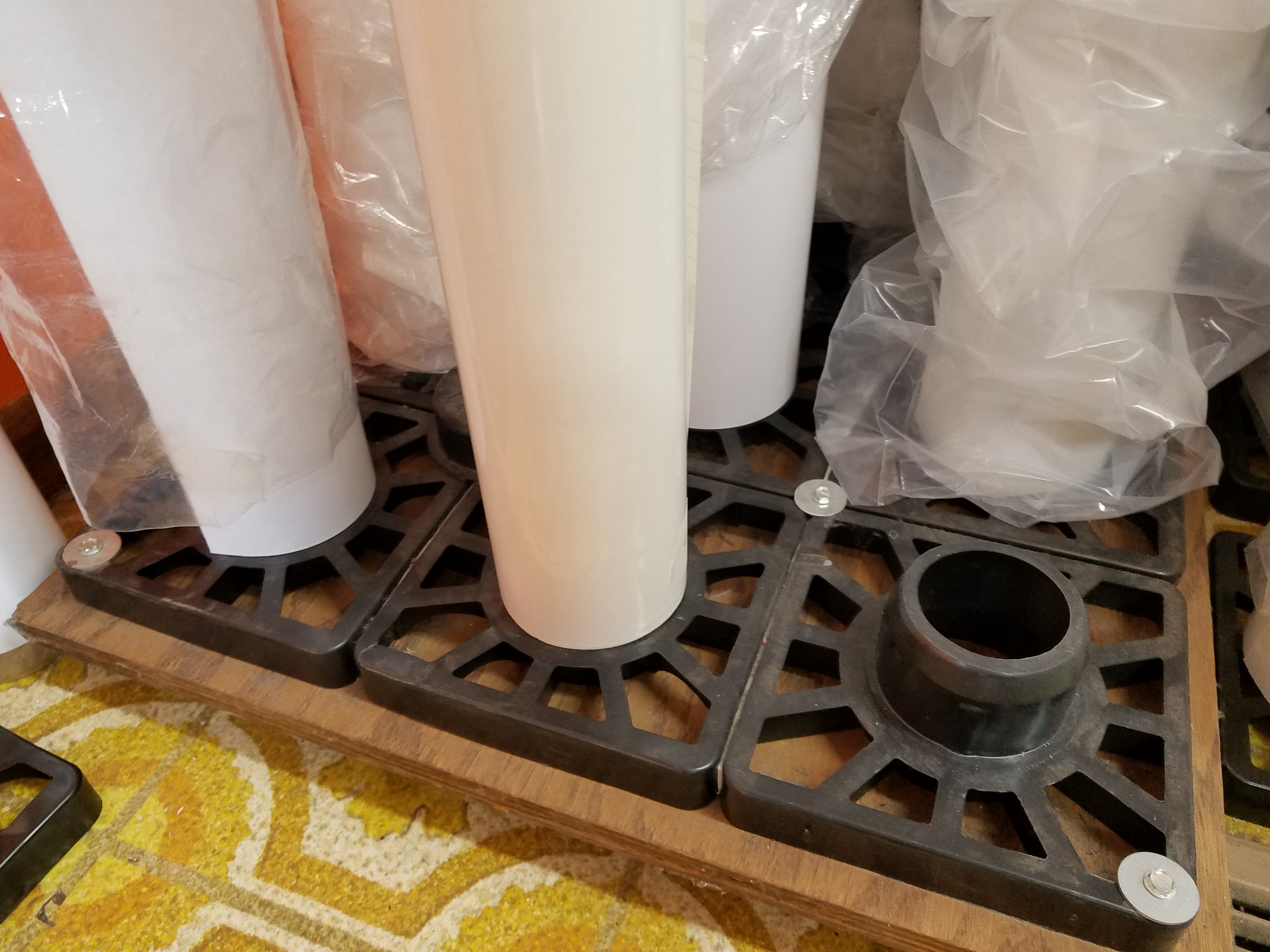

we did the same thing with our core plugs, mounting it to wood for a strong foundation.
only issue is if you want a roll that is the middle and there are other rolls around it
RedlineGraphics14
If I had the floor space making rolling racks isn't a bad idea, also for I know what you mean by if you have a roll in the middle it sucks to get to, but whats wrong with making smaller racks or say 4-6 rolls, then it eliminates the problem of having to get a roll from the middle. As soon as my shop is fully set up I will post some pictures. Is there a thread where people post shop pics?

sorry for the old bump but I think these racks look pretty good - we have TONS of rolls everywhere and we're moving and could use better organization. Do you have any more photos of them/ maybe the feet?

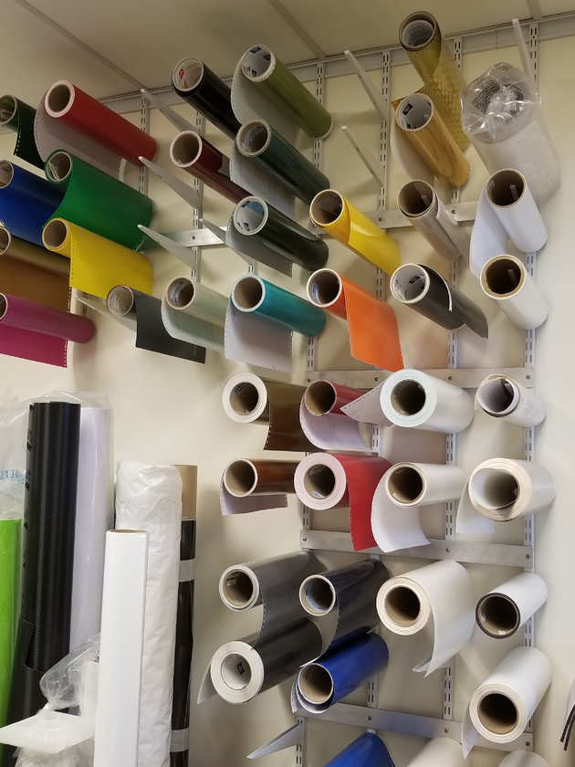

Here's what we did for wall racks to store 15", 24" or 30" rolls. It all hangs from the top track no problem and you can make it any size or change it up any time you want.
