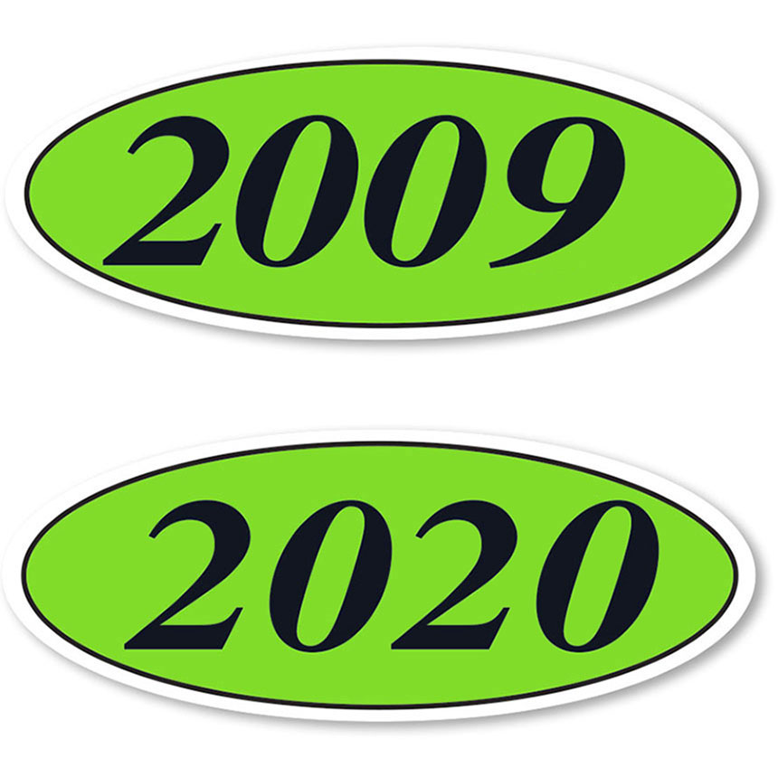

I am gearing towards your suggestions now. Now I might need a cutter that will cut out the vinyl out, like individually cut out stickers. What can you recommend?
StickerBee
Size is 14 by 5.5 inches. How much would this usually cost?
ikarasu
Summa is more expensive, but it can do roll to roll. If you plan on doing a ton of decals it's a big time saver. Ive only seen videos... But people swear by then.
Graphtec is also good... We use it to cut thousands of decals out a day. Only thing I don't like about it is roll to roll... I hear summa got a better sensor system also.
