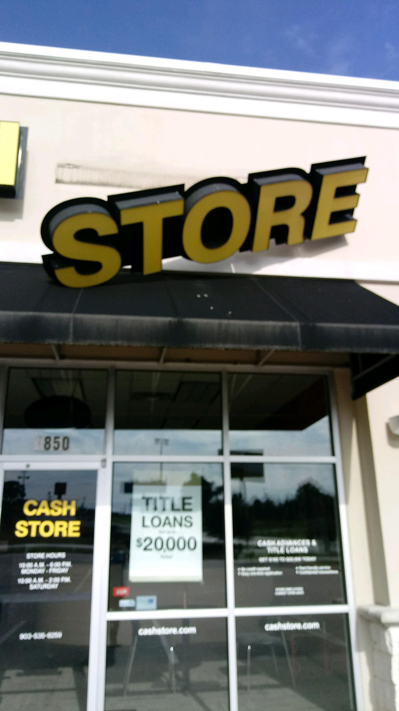

I didn't put it up and the owner doesn't know who did... it was installed less then a year ago.... Looks crazy

Maybe it looks crazy if you have never built or serviced one, but it is a pretty standard looking box, face and frame. I don't get what the issue is. Put some screws back in the bottom. Or if necessary re-drill and possibly tap new holes if the others are machine screws (usually grub screws) and that is what is needed.I didn't put it up and the owner doesn't know who did... it was installed less then a year ago.... Looks crazy

Seal your penetrations for water intrusion as well.
This is why local building officials go crazy with their codes.
They are pretty lax in the city this sign is located in. You don't need permit for anything that is less then 12" protruding from the building... just gotta run it by planning and zoning... So that means no permits for channel letters, lighted cabinets, anything on the wall as long as it's 12" or shorter in depth... It's really the only city I know of that doesn't regulate these signs and I like it that way.
If this sign falls and makes any kind of news I could just see city council meetings demanding more regulation...
I thought the face was open, but on closer inspection that's the box blowing off the wall. Yes it is a wow job. Hook on with a crane, open face and prop open, lag to wall.
I thought about it and was hoping maybe they knew who did the work... but since no permit was required that maybe they didn't. I THINK I know who did it and frankly the guy needs his ass chewedCorrect.
I'd report it to the codes officer immediately and wash my hands of it.
