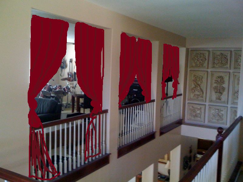

Sorry for the bad drawing.
Just use some very heavy curtains "theater style" and close them up when playing and open them up when not playing..

GypsyGraphics
I plan on spend some time this weekend pricing several of the options suggest.
I do like the theater style curtains idea, maybe for the opposite wall as well. The half of the room you can't see is where the TVs are and i know the kids would like the idea of being able to block out the light from those windows when they are gaming.
If i need to so what iSign said, and cover another wall, so of any two surfaces that face each other, one has some kind of sound absorber, then i'll pad either the wall on the music end or the tv end.
This may be something i do in steps, as i'm able to see how well each thing does at muffling the sound. Unfortunately, doing a 25' wall and those three openings in heavy fabric, is probably gonna be expensive. Even some of the insulation panels that aren't expensive alone, will get expensive once i start covering them to make them look good.
So i'm still now sure what to do, but it seems like, not matter what i do, it's going to be expensive.

Loving the look of the heavy theater style curtains and the simplicity... (duh *face palm*) you might could tack some blankets up there to see how well it will work before you spend the money, GG

How about some heavy velvet curtains like theatrical drapes are made of?
They soak up a bunch of sound, and could look quite nice since you can get them in all sorts of colors.
