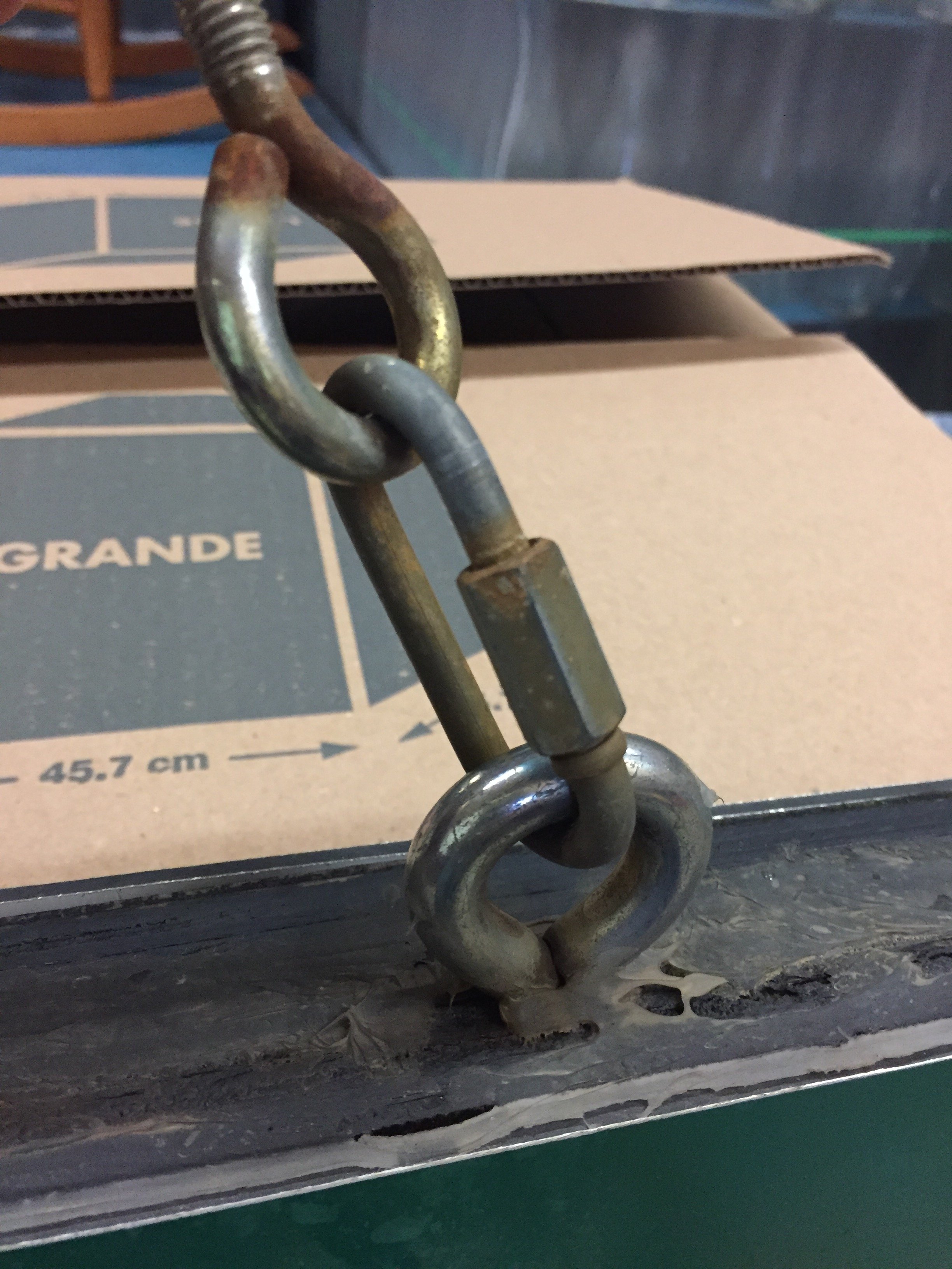

    How to repair my sign. I don’t think I want to drill a new hole so I imagine I will have to use some type of adhesive? As you can see only one of the screw eyes has come loose. There seems to be some weather protective coating along the top of the sign. Any tips would be appreciated. Thank you for your time.

    Is the frame hollow or solid?

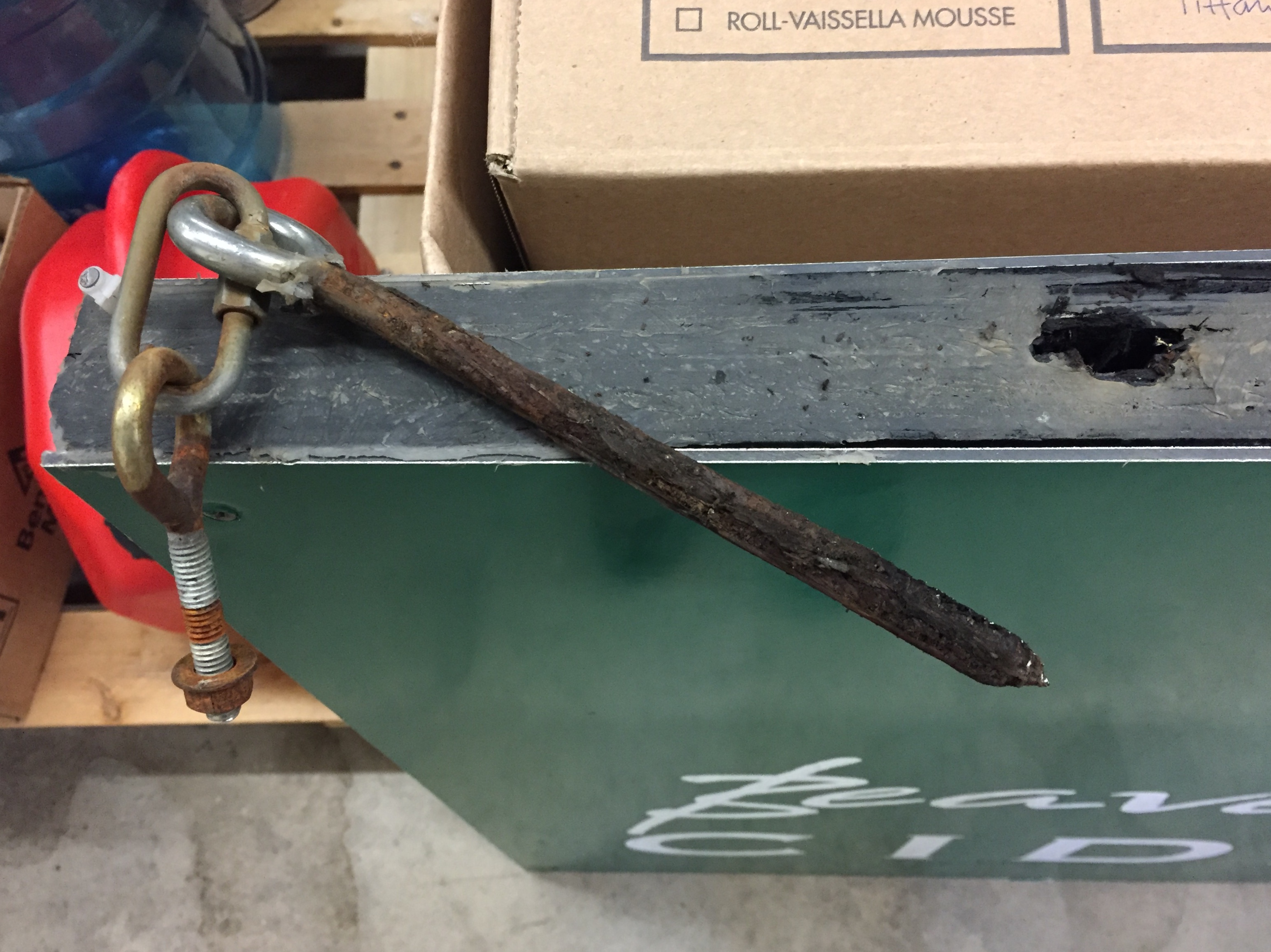

    assuming the longer eyelet is what was in the frame? what was it mounted on to in the frame
    Why is the long eyelet look like it was buried in the dirt?
    If hollow, use a wall anchor style mount, spring toggle head or a snap-toggle
    you will have to look to find one large enough for the sign.
    then come back and use sealant for the remaining opening
    How old is this Sign or is it in a harsh climate?
    Judging by the rust and corrosion on the wall anchor I would be concerned about the integrity of the PVC frame the ACM panels are mounted to

    I think the first questions should be:
    How high is this thing hanging? How heavy is it?

    Why risk patching some rusty ol' frame? Make a new one. Last thing anyone would want is a rusty old framed sign falling down on some kids skull.

    Are you a sign maker? That sign looks like it was really old when they put some new faces over it. From the looks of that "bolt" it's toast inside of the sign. Toss it.

    Hey Beny, I didn't see that you are a newbie so I want to take back some of what I said earlier. You want to repair this for a customer right. The faces look like if they are attached to the wood? with screws, make a new frame and screw them back on and replace both of the eye bolts to hang the sign.

    Yes frame is solid. The eyelet was in the frame and has corroded. The sign is 5 years old and yes harsh winter climate.

    The faces look to be just screwed onto this inner frame. If the frame is still good, run flat bar up the sides and extend it about an inch above the top with holes in the flat bar to hang it form. The screw for the side mounted flat bar will get less stress and damage as it's on the sides rather than the top.

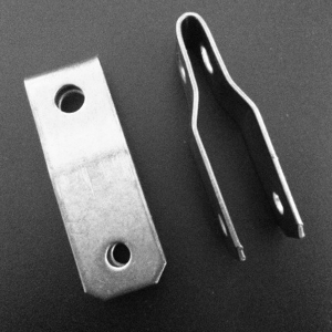

    Use these instead.
