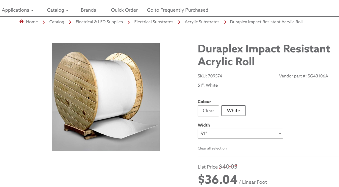

Hello, all - we are looking at doing a very large piece of sign white on an existing light box. This sign will be 48" high x 354" wide.
We were thinking of using a 51" Duraplex Impact Resistant Acrylic Roll material as we felt it would be easier to work with and transport.
Does anyone have experience using this rolled material (we have always just worked with sheets until now.

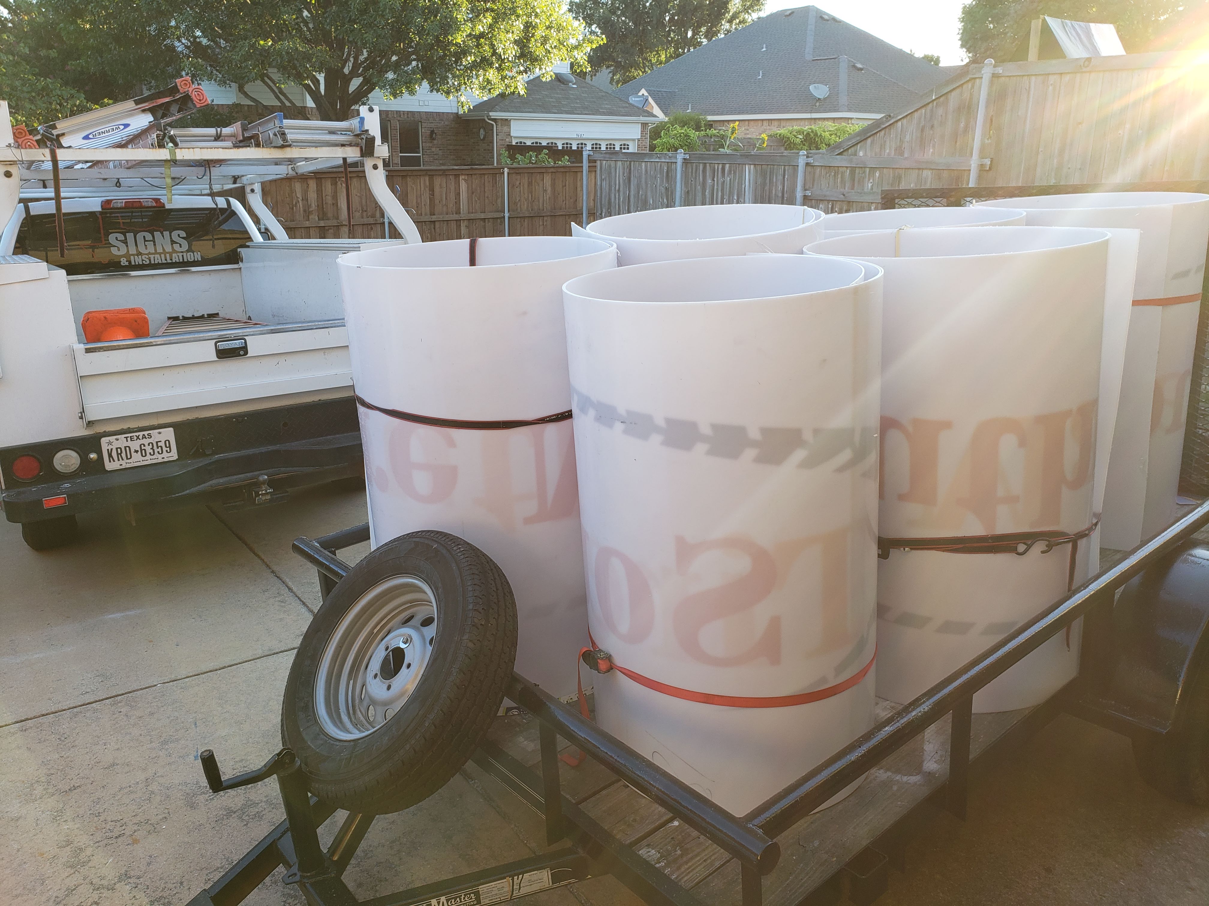

You can roll it up after making the sign. I tape over the edges so it doesn't scratch the face. I roll it buy creating the loop and laying on it while I close it up. then I use ratchet straps to keep it closed. I can do it by myself but easier to have two people.

Rolling it is not the worst, but wrap the leading edge in cardboard, lay on it like tex, and have a c clamp handy to affix it before you strap it, unless you've planned ahead and layed a strap out where you'll end up rolling it to.

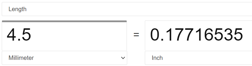

Also, .177 is heavy, we use it everywhere, but man .118" is a lot easier to roll and heave around, but it'll hotspot more than the thicker stuff.
