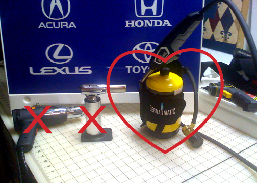

Heat Gun, NO
Crème Brûlée Torch, in a pinch, but NO
BernzOmatic... yeah baby!
(after taking the advice of s101'ers just a few weeks ago)
