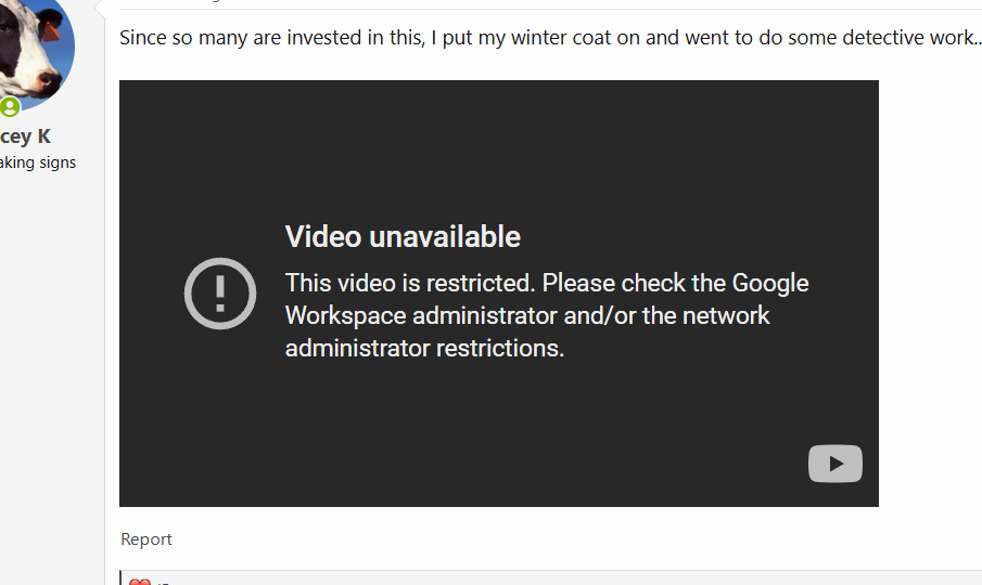

I can't see the video... is it NSFW? :roflmao:
