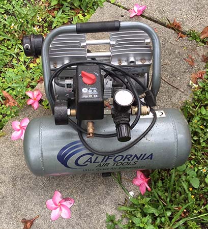

We have the 10gal version of this and it's super quiet!
California Air Tools CAT-20015HP Ultra Quiet & Oil-Free 1.5 hp, 20 gallon 175 PSI Two Stage Air Compressor https://www.amazon.com/dp/B0768FPSQZ/ref=cm_sw_r_cp_apa_i_jlgaBbW27NDZ2
The price point puts it to a 3-to-1 ratio which is nice. It looks like a solid unit. I will have to compare the dba ratings on the scroll version above and this one. That unit is about 15 dba below the Kobalt we currently use in the shop. Thanks for sharing the info!!!!

I have a portable California Air for running my nail guns and for spray painting. Super lightweight and ultra quiet. I bought it off their website years ago after seeing it at a trade show. I wanted something light to bring on a jobsite when building stage props
and not be noisy.

I'll add some more positive feedback for California Air Tools. We have one of their small compressors that we use with our laminator. It's not silent, but you can have a phone conversation 10' away from it. Their support is great - we've had a couple minor issues with ours and they've always been helpful even when the warranty was over. I know they make a cabinet that can further reduce the noise, but it might not be available for their larger compressors. Of course, you could always build your own cabinet or move it to another room.
