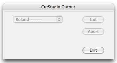

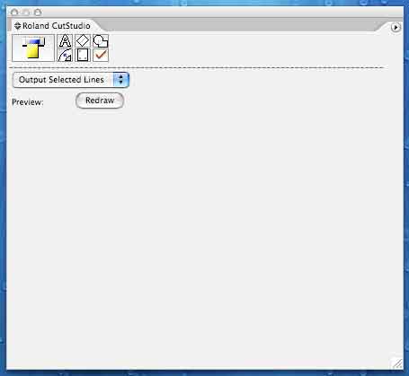

Well, I think CutStudio on the mac is a little bit more basic than it's counterpart on Windows.
I have attached screenshots of my windows and I don't have any options like that.
Plus side is the first responder inspired me to look at the manual online, which offers the handy feature of a search button, and it looks to be buried in the control panel after all. I must not have dug deep enough.
Sure would be nice to control it from software like it appears you can on Windows.
