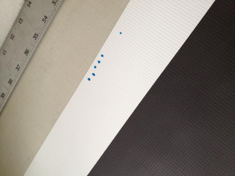

Using 13 oz ultraflex matte banner. I keep getting small drip spots on the edges, if it's on one edge it's on the other directly across. Every once and a while there will be a few drops in the middle area but mainly on the edges.
This particular job was a 100% K black banner and it had blue drips.
I don't notice this on vinyl just banner material.
Thanks!
Roland Versacamm 300i with OEM inks.

It's the result of the head pinking up a piece of lint. The ink collects on the fiber then runs down, dripping onto the media.
Even though you set 100% K in your file, your rip will interpersonal the color and balance the ink load out using all of the colors. If you want to avoid this turn of all color management within your RIP software.
miker
Ultraflex (and most scrim banner) tend to have a little fuzz on the edges of the roll that will wipe against the bottom of the jet plates and cause little drops like this. You can take a propane torch or lighter and hit the ends of the roll for a split second and burn them away.

This is what i figured but wasn't sure.
I printed 12 banners the past 2 days so i guess this did it.
Thank you guys!
GAC05
Quit buggin' me
After a run of banners you should check your print head and capping station for those hairs even if you don't see any drips. Those things can build up enough to keep the cap from sealing the head when it is parked.
Flashlight, tweezers, swabs & a little cleaning solution after a banner print.

Cleaned the machine yesterday and ran another banner, No drips.
