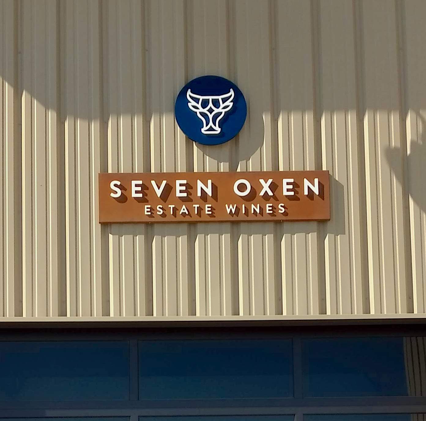

Oooh, I don't know if you're going to get a sheet that size. We work with this stuff all the time and have a really hard time getting CoreTen in anything over 48"x96". We're located in an area with over 300 vineyards within a 25 mile radius and nearly EVERYBODY wants CoreTen incorporated into their signs. It's a fad, kind of cowboy chic out here.
We used the White Vinegar/Hydrogen Peroxide/Salt formula on these and it took a couple of treatments, but its rusted across the entire surface within the first 15 minutes of the first spraying.

The theory behind CoreTen is that once the surface alloys finish rusting, they seal themselves by creating a somewhat hard shell finish. The rust quickening process creates a rusty powder on the surface, but we remove that after we're happy with the finish and its pretty much up to the weather to finish the process and seal itself.
