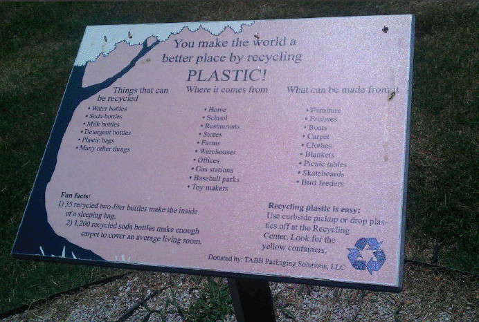

    SO I have a customer that wants 10 12x18 pedestal type sign as per the attached pic. This is a lot like the aluminum plaques available from gemini, but obviously not a plaque, but at the same time needs to be durable and resistant to tampering. Thanks for the help.

    Print and stick to any ACP material then place a sheet of acrylic or lexan on top
    since you are in AZ may lean towards lexan as acrylic can warp in extreme heat especially if not thick enough

    http://www.fossilgraphics.com/
    These guys can help - a spendy product, but will last for ever. No digital print that we guys produce will come anywhere near.

    We've done them in house, reverse applied to matte clear leaxn then bolted to a base.
    Or if the budget isn't an issue go wih fossil
