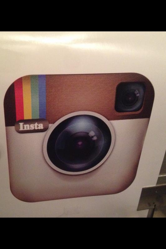

    I've added a picture of the test print and also added a picture of the sticker im printing for the job.

    I've had a similar issue in the past. From the test print, it still seems quite good to me.

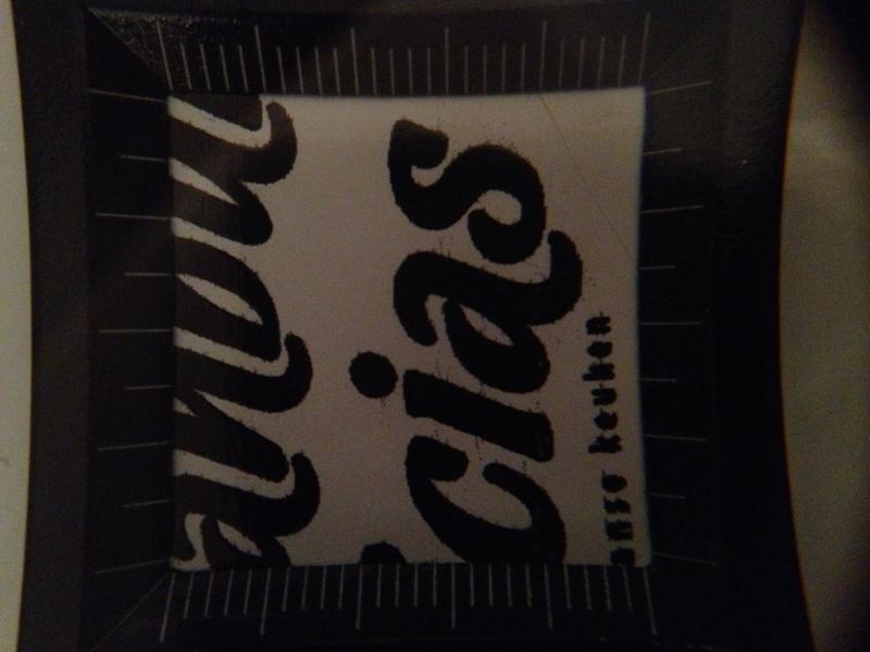

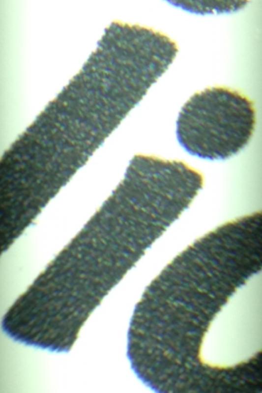

    I've done some test prints and they turn out much better with the pc suggested by alymer, I took another picture through the magnifier and zoomed in a little. It is noticeable that the borders of
    the letters are not really accurate. However i am fine with that but now my black is not really black, as you can see other colors are visible in black. But btw the headheight on the sp-300 is not adjustable i only have one normal setting and thats it basically.
    I guess i will have to tweak the pc a little more, maybe up the percentage of black ?
    I also made another print with the exact same settings, it looks to me like there is some light banding in the print. But my question is, does this print look satisfactory to the trained eyes over here ? It is a 720 by 720 dpi print. If not could you give me some tips on how to improve my prints some more ?

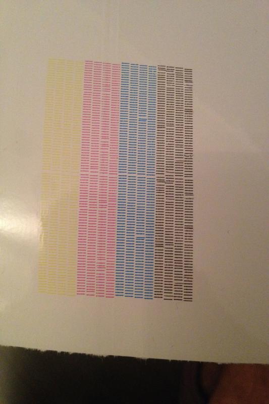

    Your nozzle check looks like your calibration setting is off a bit - there is a slight gap in the two sets of nozzles. you can perform the calibration via the menu section fro calibration.
    For your black not being a true black - try either checking the preserve primary color box under the settings tab if you are using 100% K channel or use the Roland spot color of BK-21A instead to get a good black. If you are using RGB try a value of 0,0,0 to get a good black.

    I finished the job and the customer was really satisfied, thanks for your help guys. Checking the preserve primary really made a big difference.
    About the gap in the test print... I don't know why but this calibration gives me less banding than when i calibrate the machine so that there is no gap.
