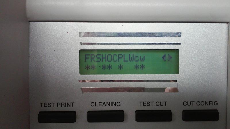

Here is a picture of what I was talking about.

i think the W is the proximity sensor, it should trigger when it's to the right of the platen, and when it crosses the pinch rollers.

W is the pinch wheel sensor
It will show you a * under the W when the pinch wheel sensor (on the back of the cutting carriage) senses a pinch wheel.
