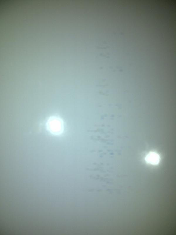

Well I tried the medium cleaning and still nothing. It looks like no ink is getting to the heads. The ink tubes leading to the head are empty. I'm a little nervous that usually when you do a test print its four lines (4 colors) but when i did it this time all the lines were overlapping with hardly any color. I also noticed when I put a sheet of vinyl in (approx 20" wide) the sheet scan still said 49.3"...... :banghead:
Any more suggestions for the next step? I'm pretty new at this but I think if explained I could try the syringe procedure.
snowmancanada
I took a pic of my test print.. I can't get a roland tech to visit until next week. I'm scared the my machine is messed up good! I find it weird that all colors tried to print on the same line. The total width was about 2 inches.

Remove the cover in front of the pump and suck some ink through the capping station with with a syringe. Make sure your dampers are full and no air in the lines..God hates printers too, cos he has never worked them.

Airleaks cause bubbles, but when a printer is disturbed or transported, the inks run back to the cartridges.. 100 mills of ink between the cartridge and the heads on a 540. make sure you suck at least that much on each line.. best to remove the dampers and suck the ink to them with a syringe first...suppose I should say check you have plenty of ink in cartridges first
