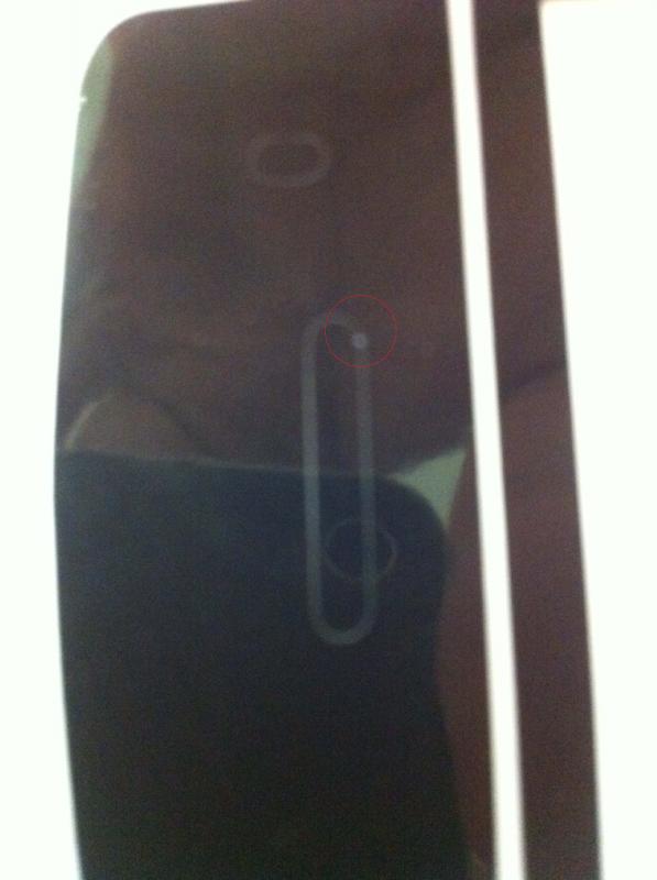

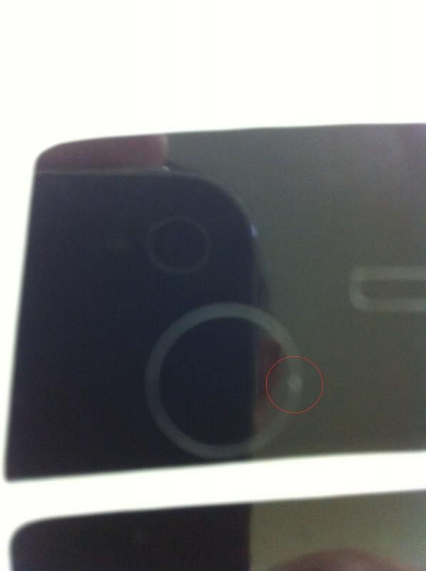

    Still not cutting right...
    So i'm back with good news and continued bad news hahah. I have replaced the blade holder, cutting strip and purchased a few new blades. The cutting is unbelievably better but not i have another issue that i can't seem to resolve. It seems like the cutter isn't finishing the cuts completely if that makes sense. It leaves a tiny dot (best way to describe it) so when i weed the area i need to essentially rip it off. It doesn't look too bad but again doesn't look perfect. Any ideas on why this could happen. I have tried adjusting every cut setting there is with no success. The interesting part is that it's doing it at the same spot every time so i'm assuming it's where it starts and ends.
    I took a couple of pictures but it's a little hard to see. You will notice around the cut area that the cut line doesn't look the same in just one spot. Let me know what you guys think please. Thanks.
    Oh and one last thing, it did the same thing every time i did a test cut. The top part of the circle was always incomplete.
  16. txsurfer
    txsurfer Member
    284
    16
    Oct 29, 2005
    Texas
    Always round the cuts slightly
  17. kmajid
    kmajid Member
    47
    May 6, 2009
    Thanks for the response and excuse my ignorance but what do you mean by rounding the cuts slightly?
  18. txsurfer
    txsurfer Member
    284
    16
    Oct 29, 2005
    Texas
    instead of a 90 degree angles in a square or rectangle put a slight rounded corner on it, this keeps the blade from lifting up.
  19. kmajid
    kmajid Member
    47
    May 6, 2009
    The issue is that it's actually doing it with circles too, so every time it starts and stops it does it. Is that normal?
  20. txsurfer
    txsurfer Member
    284
    16
    Oct 29, 2005
    Texas
    It shouldnt do it with circles, have you done a cut alignment
