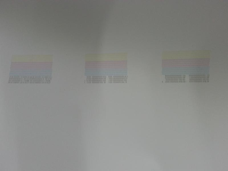

I noticed that my blacks weren't printing solidly so I ran a print test to see what was wrong.
I've ran several (4-5) medium cleans and about 3 powerful cleans but the resulting print tests are erractic. Wipers have been replaced but I'm waiting for cap tops that are being shipped to be replaced, I've soaked the heads in the cleaning solution overnight, flushed the ink lines (clean), used the cleaning cartridge several times. Cleaned around the cap top and around the print head.
Is this a sign that my Black/Cyan print head nozzles are bent and that it needs replacing?
Thanks!

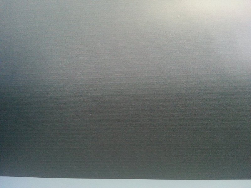

When I try to print 100% K, it ends up with banding as shown below.

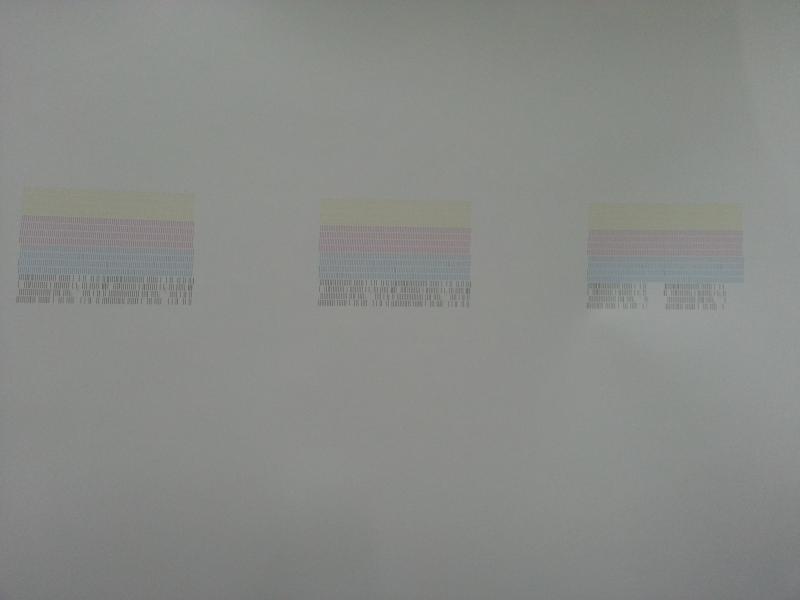

I've noticed that when I do the tests that the middle and top sections of the black section are missing so I'm guessing that those particular nozzles are severely clogged/blocked or bent.
wedosigns
I don't think your head is gone. From the images of your test prints your missing nozzles are moving all over the place. This would indicate one of two things to me.
1 Your cap top is not sealing correctly, therefore not creating enough suction. You stated you have one on order. In the mean time you can try cleaning the one that is on it now. Pay special attention to the rubber seal. Make sure there is no debris or ink dried on that seal which would let air in.
2 You may a bad damper, or o-ring that is letting air in. Try pulling off the damper to see if the ink evacuates the damper. If it does that would tell you that air is coming in. Replace the damper or check the o-ring connections all the way back to the cartridge.

Even with replacing the captop, I do not think it will resolve the bent / permanently deflected nozzles... head replacement
