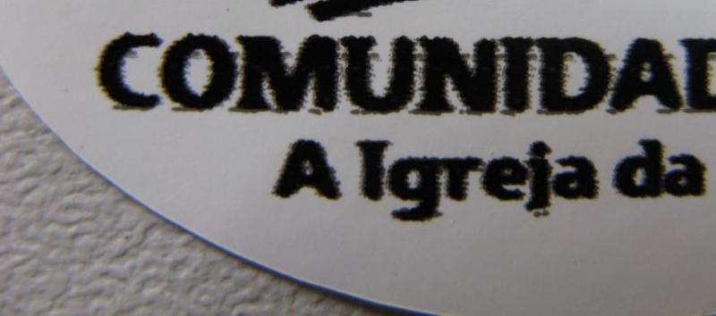

I Have one SP 540V and have this problem:
attachment.php
Its fine lines around borders only on black print.
Someone has seen this problem?

Try cleaning the encoder strip with mild alcohol. This strip is directly behind the wire cable and runs the length of your print area.
