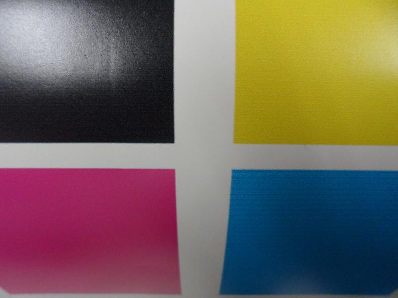

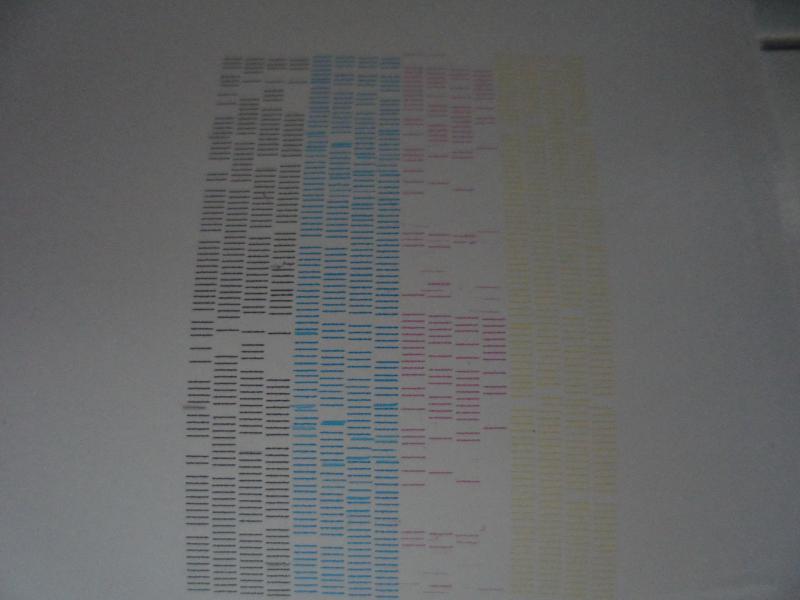

Setting up the sp300v after she was sleeping in a crate for 2 months on its way from the US, now I managed to have it printing after having to syringe the ink from the bottom of the cap tops before the pump, and while she's printing, the quality is not something that I'm excited about.
Made several cleans, manual around the head area, wipers replaced, bi-directional adjustment done, but still get some banding and lots of dropouts on the cyan head.
I'm new to printing and to this Roland, so please bear with me. I did all the tests I could based on the info I could gather from here and other forums, so any help would be appreciated.
the CMYK squares were printed in a mactac matte I have for tests, standard quality, bi-directional. I did a nother test (not pictured) in standard quality but uni-directional and it looks the same.

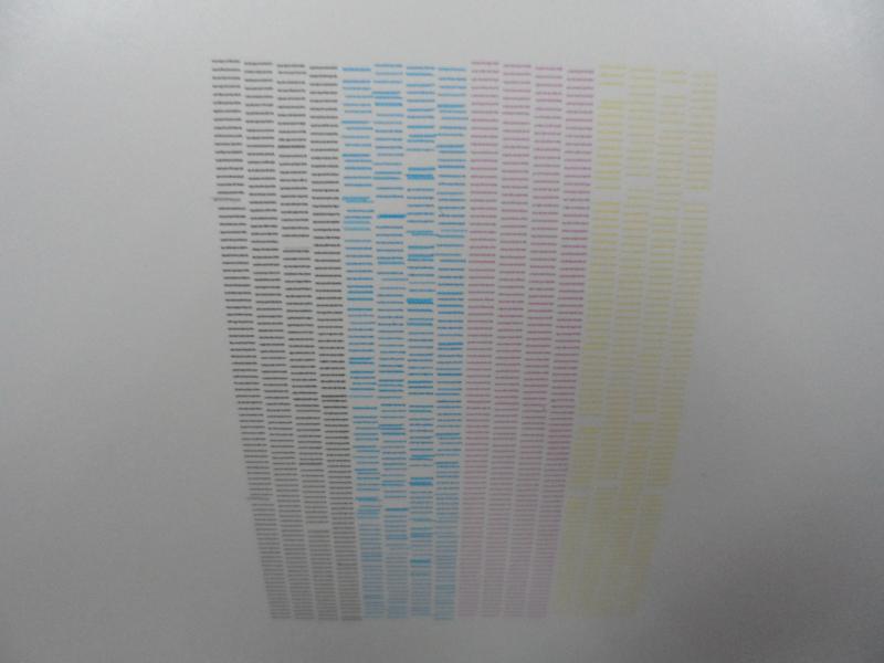

Let the head soaking overnight and did a couple of cleanings today, now the magenta is messed up :(
Ink is getting low, replacing with new cartridges could help in any way ? Have a new set of 440ml OEM ink but I decided to wait until I was able to have the printer in good shape and printing properly, but I don't want to damage the machine just because I'm cheap
wwpro
here's the latest test print, looks like crap, and the CMYK squares (no pic) are showing, obviously, a lot of banding and the black is green now.
Kinda want to get this rolling, so any help you guys can provide it would be appreciated

If cleaning routines are making the problems worse, I would replace the CapTops for both printheads. These are user-replaceable, and run ~$25 ea. Should take just a few minutes to replace - just be careful with the springs.

You looked to be close to a good nozzle check, then it went down hill, been there done that.
It seems that the ink that's in there is casuing you problems, though you may have other contributing factors also
It may be worth reverse flushing the lines, including the dampers, with cleaning fluid.

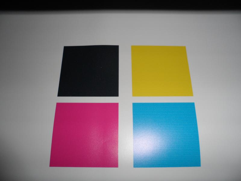

well, replaced both captops, replaced the missing spring with one from a pen, let the head soak for some more time with some paper towels over the caotops saturated with cleaning fluid. Now is printing much better, a little bit of banding but acceptable in standard quality, so happy overall.
Thanks to the 3 people who helped me posting in this thread.
demandattention
Just saw this post. I too had a similar issue and it was the cap top. Glad you got it fixed. I was told by a tech that to many head soaks will give you issues as well. After a day or so of printing and normal head cleanings you should be in good shape.
