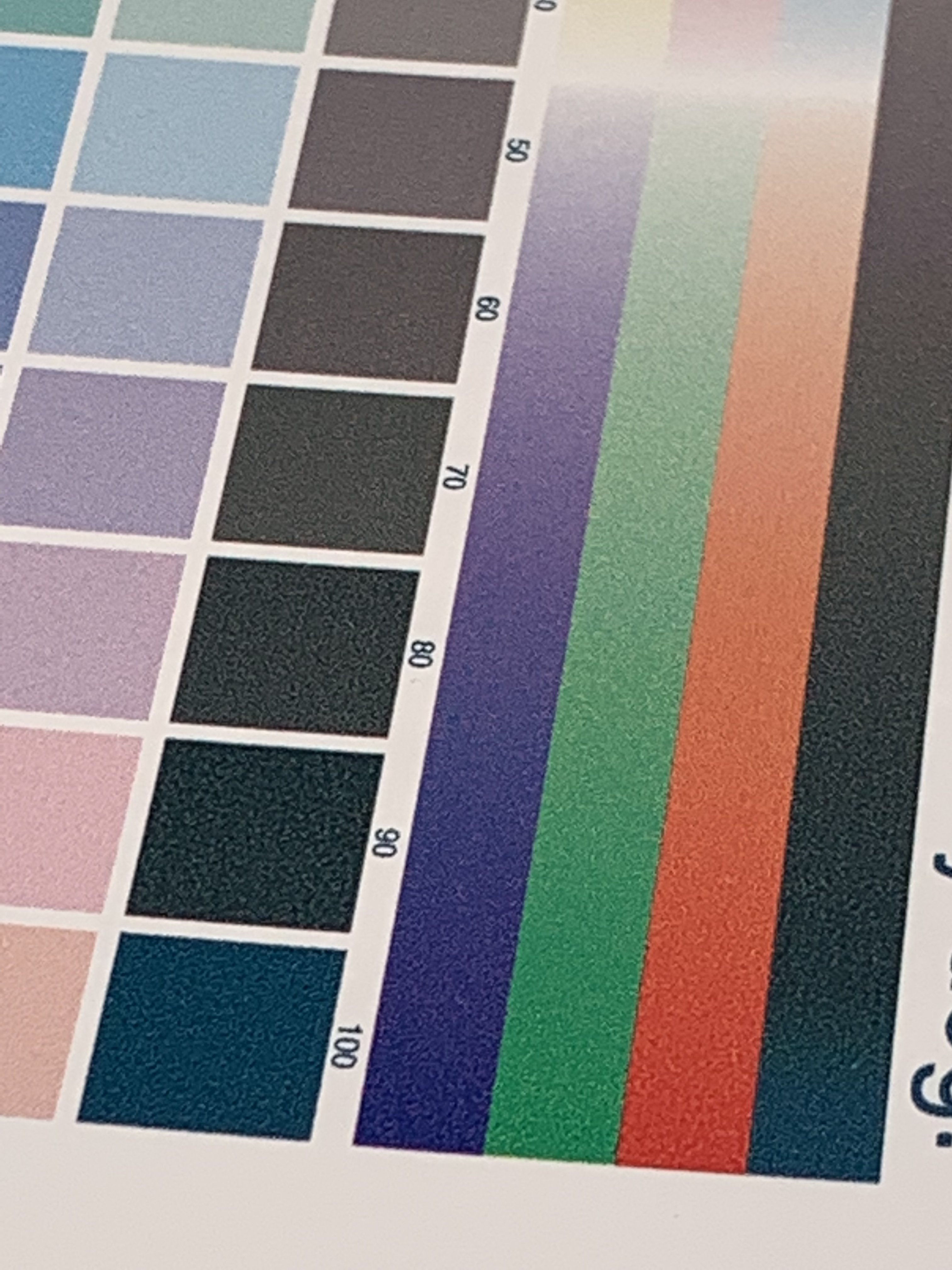

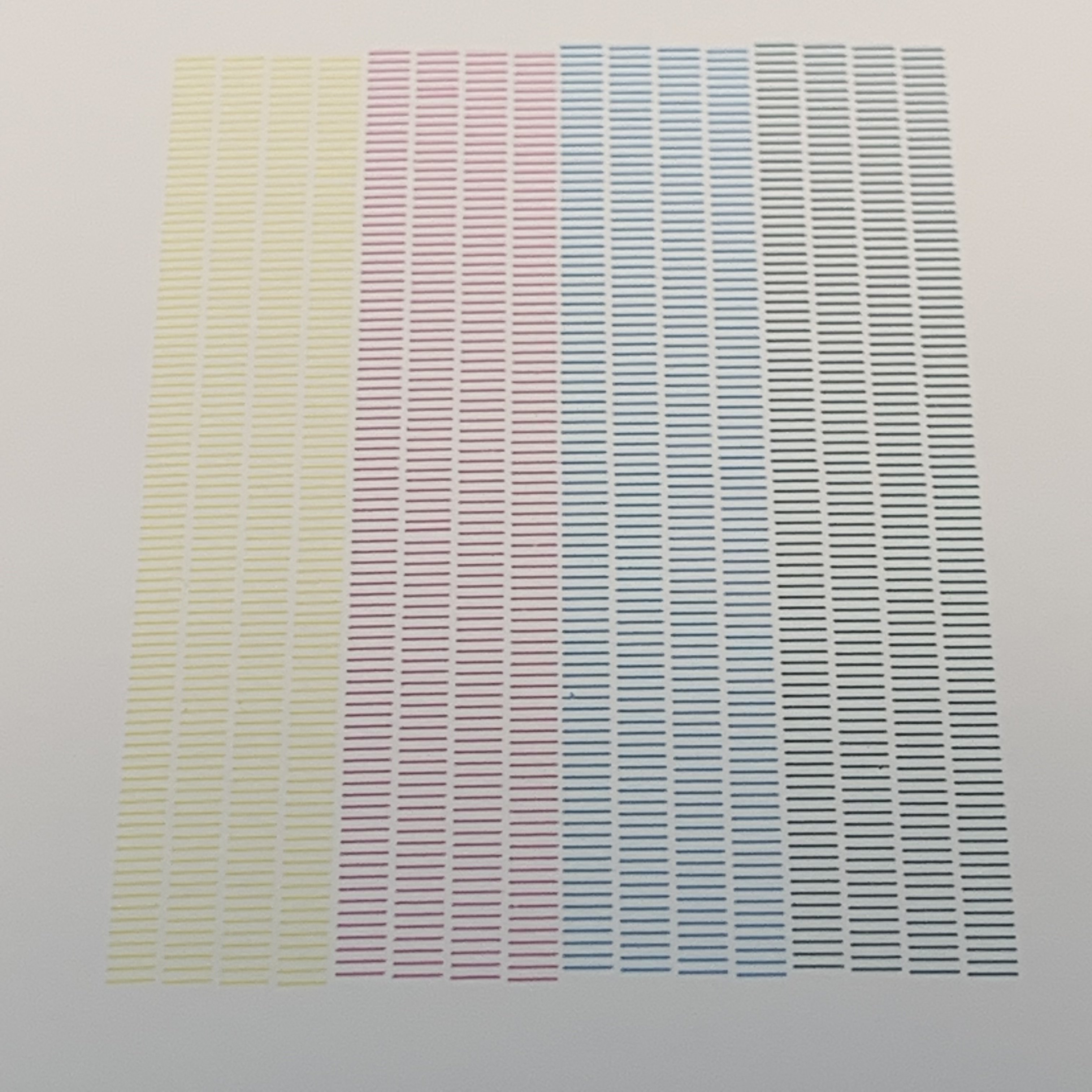

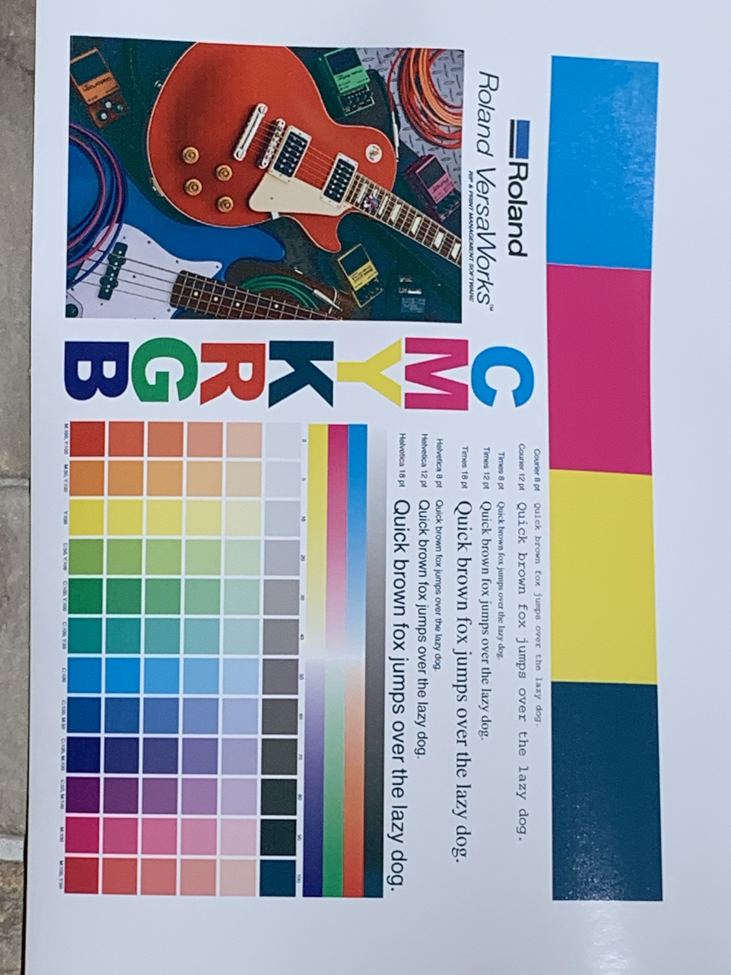

I now just printed the test print with the color swatches thru Versaworks and the 100%K looks a bit cyan/faded light? On the gradation scale it looks fine until it gets to 100%K and there it has a cyan tint? How can this physically happen when only black ink line goes to the print head? Could have some cyan ink soaked up into the black print head and I am getting a color shift till it is printed/drained out?. I'm not talking color calibration when printing a file, this is the factor color test print I will post pics of it next, the nozzle check also shows the black head printing but it doesn't seem to be a solid black color?
I did take out the ribbon cables when replacing my encoder sensor and just put the ribbons back in the proper slots. Nozzle check looks fine. Any ideas?

Here are test file prints.

That's happen to me. (same printer) Some cyan has back flowed into the head/damper/ink supply tube (depending on the amount of migration). Mine was Magenta in the yellow after a head soak. (Easier to see in test print) Cleaning cycles and printing all day didn't clear it up. I end up unhooking the exit hose below the cap at the Y before it goes into the pump and using a syringe to manually pull/prime the tainted ink through. "Wasted" 5-10 ml of ink, but was back to printing fine immediately. Hope this helps.

Thanks I'll try it and draw some black ink thru to manually flush it from the damper. But any idea why in my test print you can see the 100% K swatch going cyan when all the other K swatches are nice and gray/black? You can also see it at the end of the white to black gradation strip...

The printer also "makes" black by using M,C & Y. (no need to use the B) This is similar to a RGB Black and mixing paint. You can get a nice black with paint by mixing all the primary colors together. I haven't actually mastered creating a print file where I can "force" the printer to use only the black cartridge. Hope this helps
