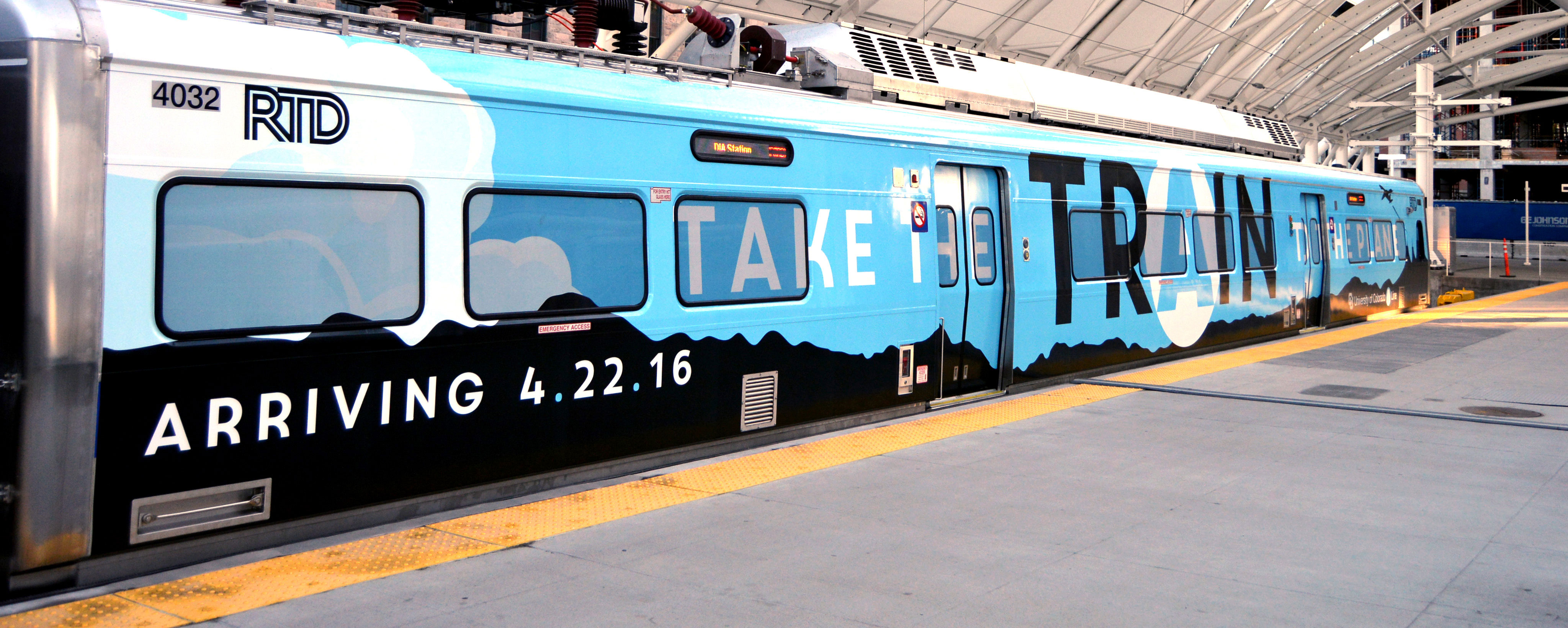

4 Of us use to do 80ft by 11 ft transit trains in 4 hrs. 2 a day.
