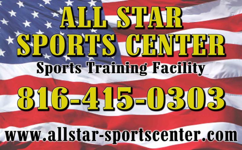

    Just wondering what some of the pros think of this sign layout. It will be a front lit 3x6 parking lot sign, and the owner wants to keep with the stars and stripes theme.

    Neither one passes the squint test. Lettering on the American Flag is hard to pull off because there's no contrast. Try fading the flag in the background instead of keeping it at 100% opacity.

    Honest opinion, I think it fails on several levels.
    1. The flag background is overused. You can have a "stars and stripes" feel withought an actual flag.
    2. The yellow text just doesn't work, and seems crowded in the sign.
    Try to do something that let's people know that the facility is a sports training center -visually.
    Gary

    The opacity of the flag is at 85%

    It's not working at all. The flag image is too prominent, and the problem there is going to be that if you lower the opacity enough that it doesn't take over it's going to look really faded. You really need to lose the flag or find a better way to work it in.

    The only way it may work with the flag, is to put a white glow around all the lettering to separate it from the flag, still probably is not going to look well, but may bring the lettering off better than now.
    Honestly I would talk my customer out of this, as it will be very difficult to read. As others have stated you can give him the red, white, and blue in a different type of layout and get a much better effect. Remember your customer needs to get the best of what they pay for, and this will not justify him in the long run.

    It's sacrificing legibility for patriotism.
    It's also busier than a cat trying to cover crap on a marble floor.
    There is no focal point but the background, and that is not what should be the most important part.

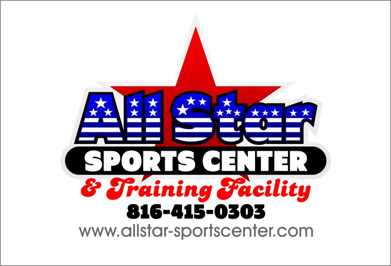

    There is a new set of fonts out from The Fontry with a patriotic theme, you would have to contact Michael Gene directly in order to get this set. But you can seperate the colors (I didn't here) to really look like a flag.
    (I think he also has a Canadian flag version)
    The wording is redundant, as the subcopy also says "Sports" I would see if that could be changed. The phone number has as much weight as the name.
    The yellow clashes.
    Here is a suggestion, not the best, as the big star may present a problem.

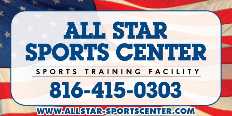

    you mentioned the sign is supposed to be 3'x6'? ...a heads up...the sign you submitted does not scale to 3'x6'. It scales to a 44.8''x72''.
    on to the layout... As mentioned above, the layout is not very legible. Show the customer the layouts he has requested so that he can see that they are not functional and then show something that is...

    Custom signs and designs, I would listen to everyone here they got good advice. The two layouts that you are showing are not working.
    I think what RJ P. JR has come up with really nails what you're trying to achieve. It has a red white and blue theme and everything can be read easily. The borders are not being crowded and it flows. You could probably even put.com at the end of his name and a light color - between sport and center.

    rjpjr has a really simple legible solution!
    Nice varying line weights as well.

    The layout in post#9 would look even better without the flag. Something more geometric would work better than the photo.

    rjpjr nailed it, that's a nice layout.
