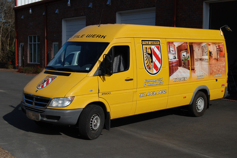

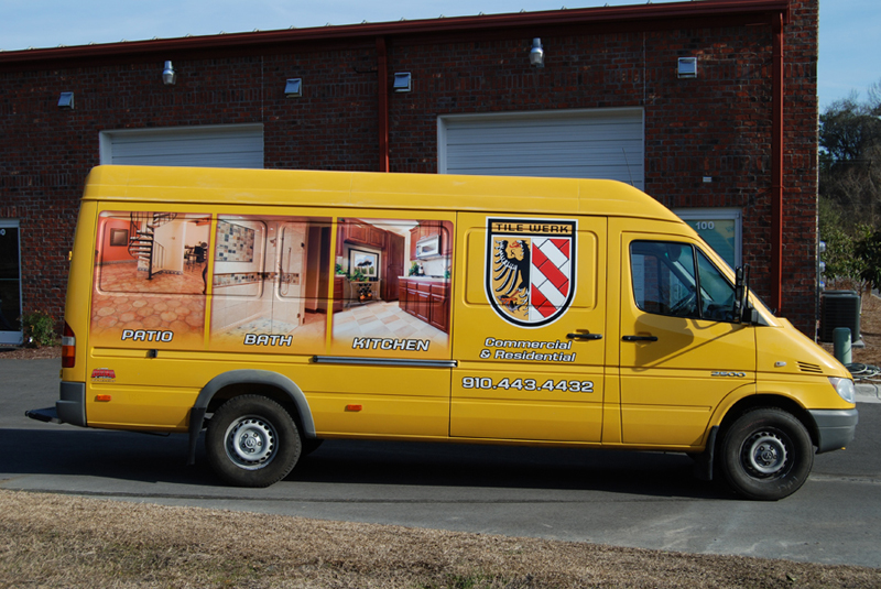

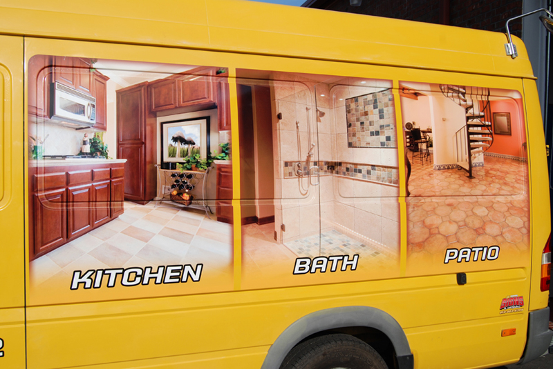

Well thanks to everyone for the advice. The install went pretty smoothly for my first attempt and I think everything came out pretty clean!
I attached some pics of the finished product...
