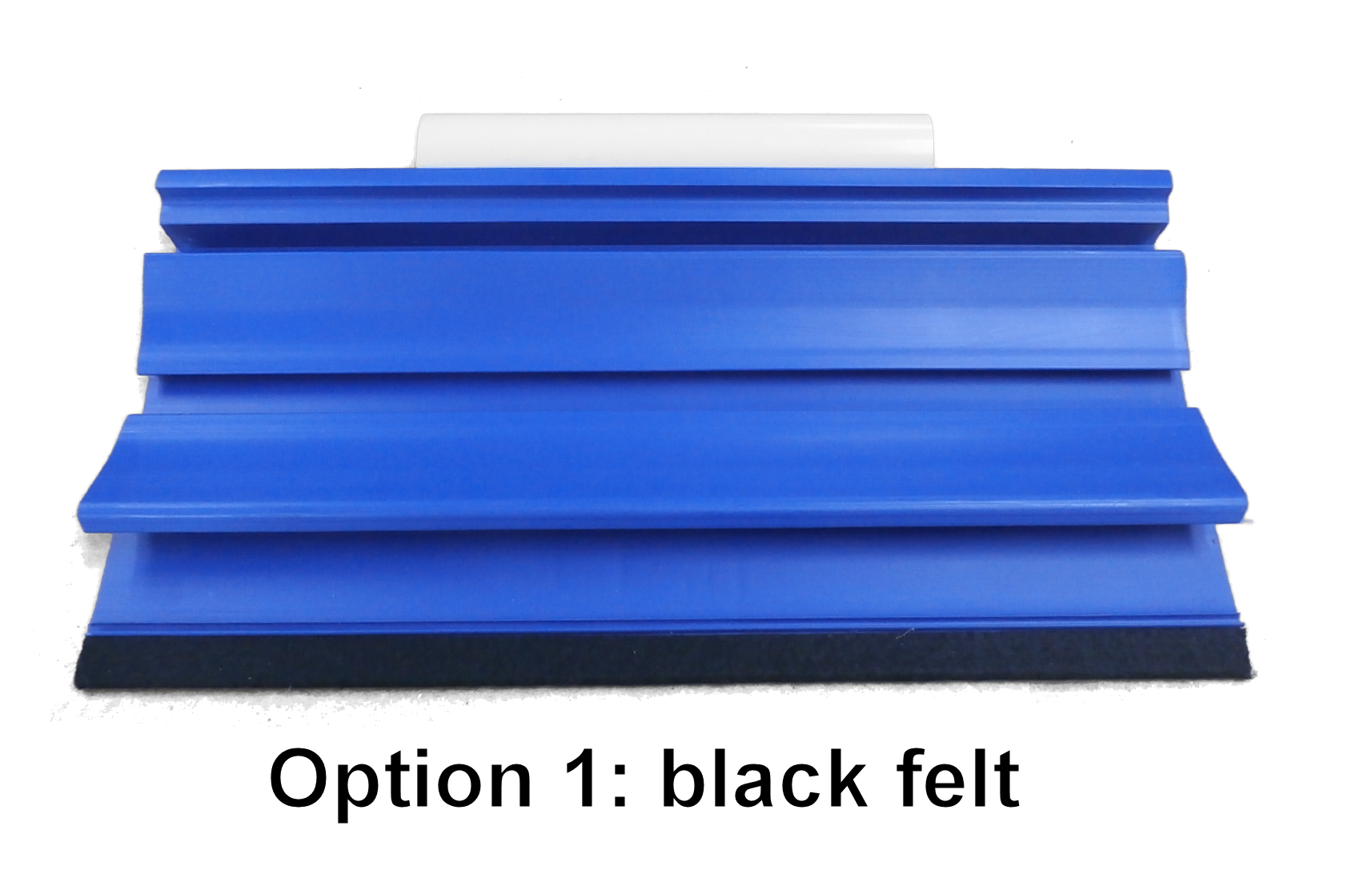

Sorry, you could not get in touch with me. I don't know what the problem is with my phone. I get calls everyday with no problems that I know about.
The good news is that plastic is back. Well, it is not the same as the original but it is extruded the same way as the aluminum. We just got it in a couple of days ago so I'm still sorting through its capabilities. It is much more flexible than the original tools though but you can attach stuff to it the same as the aluminum ones. I'll be putting them up in the website later this week or early next week. So far i'm having some issues with the edges not being straight enough which can be expected of extruded plastic. I will have to set up for machining the edges to make them straight so I'm not quite ready to offer them for sale.

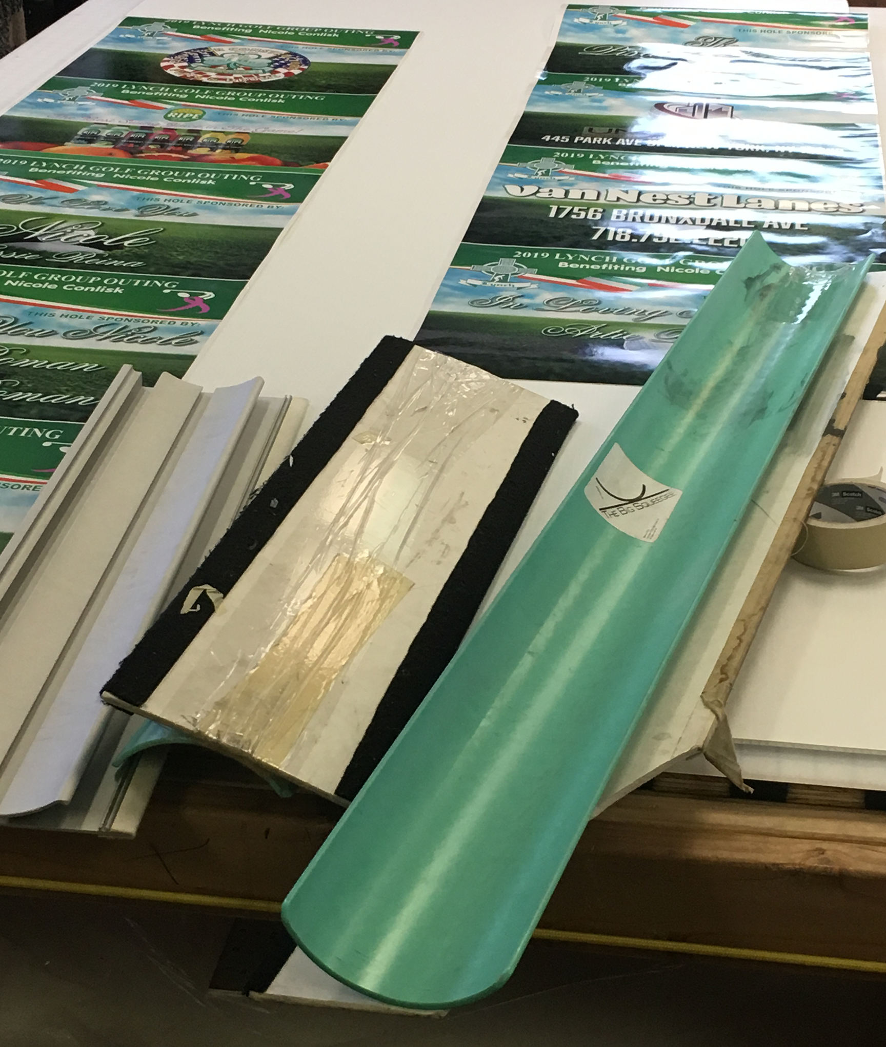

Love this forum. You were totally correct. I let a friend built my present table 6' x 10' and it is slightly concave. I'm glad we can purchase the originals. I still prefer the original plastic squeegies. Here are what mine look like right now. We are completing 125 signs for golf outing.
