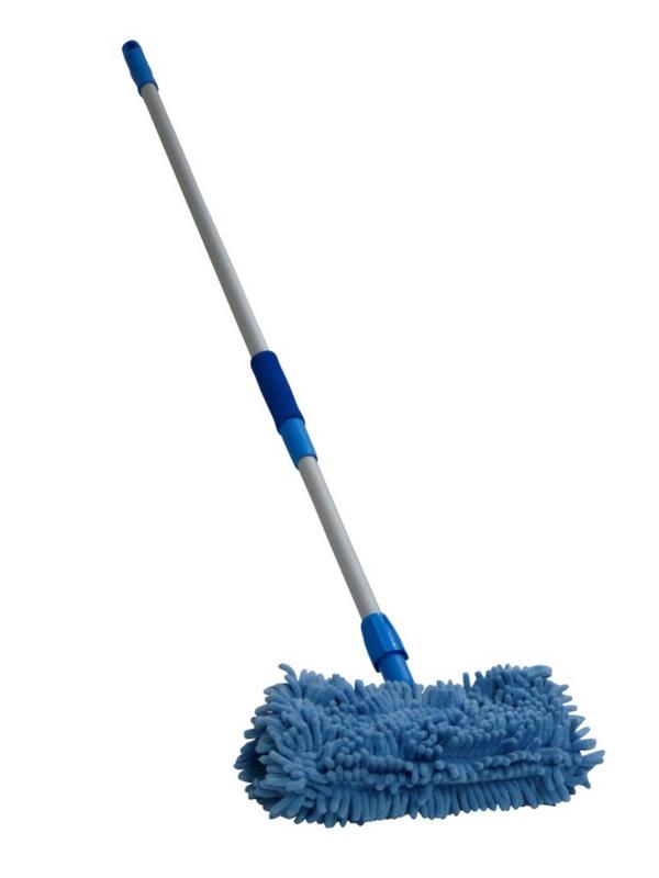

It looks to me like you're running your print heads too high.
If you leave too much of a gap you get more of a "ink mist" and the static
in the material will suck it in, or worse, it will collect on your print heads.
I almost never have static issues because:
1 I run my print heads as low as is safe
2 I run a Dry micro fiber "mop" over my substrates, I have
a long wire running from inside the mop head, up the handle, and
grounded via the ground on a electrical outlet. see image below
attachment.php
3 I have also had to spray down my concrete floors with water when the humidity got real low in winter.

THIS .. Since I have posted we have figured all of these things out.. And we were running the head to high.. we stopeed wiping down with alcahol as well..
we just use the mop like you have, run the heads low, and keep a damp cloth on the edge of the gantry..
All has been well Thanks !!

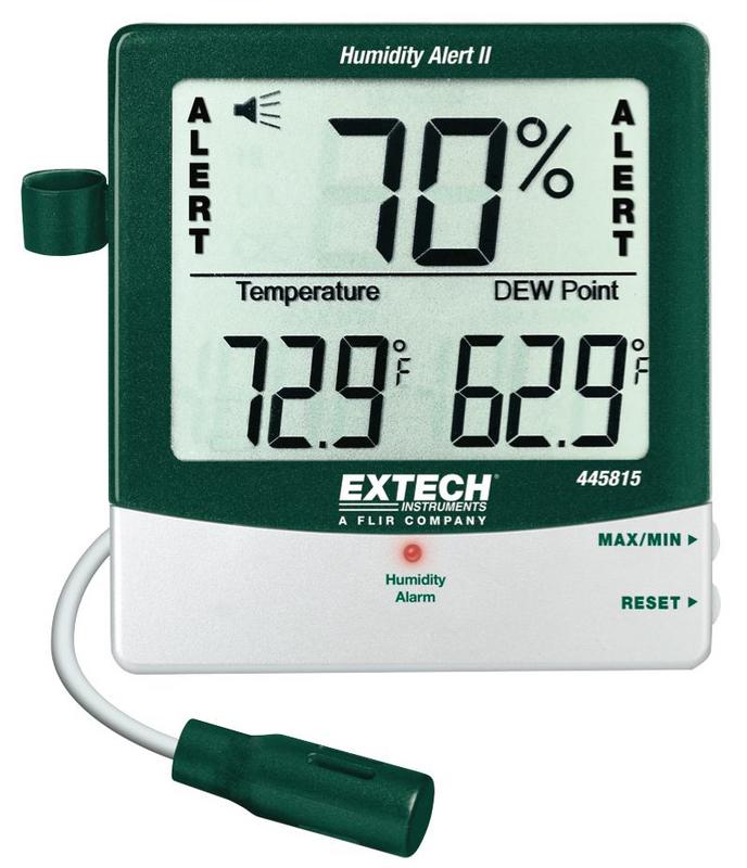

also, if you don't have one, you need to get a humidity/temp meter, I have two in my print room similar to this one:
attachment.php
My ink says 40% - 60% humidity, but as long as I'm over 30% I'm good.
