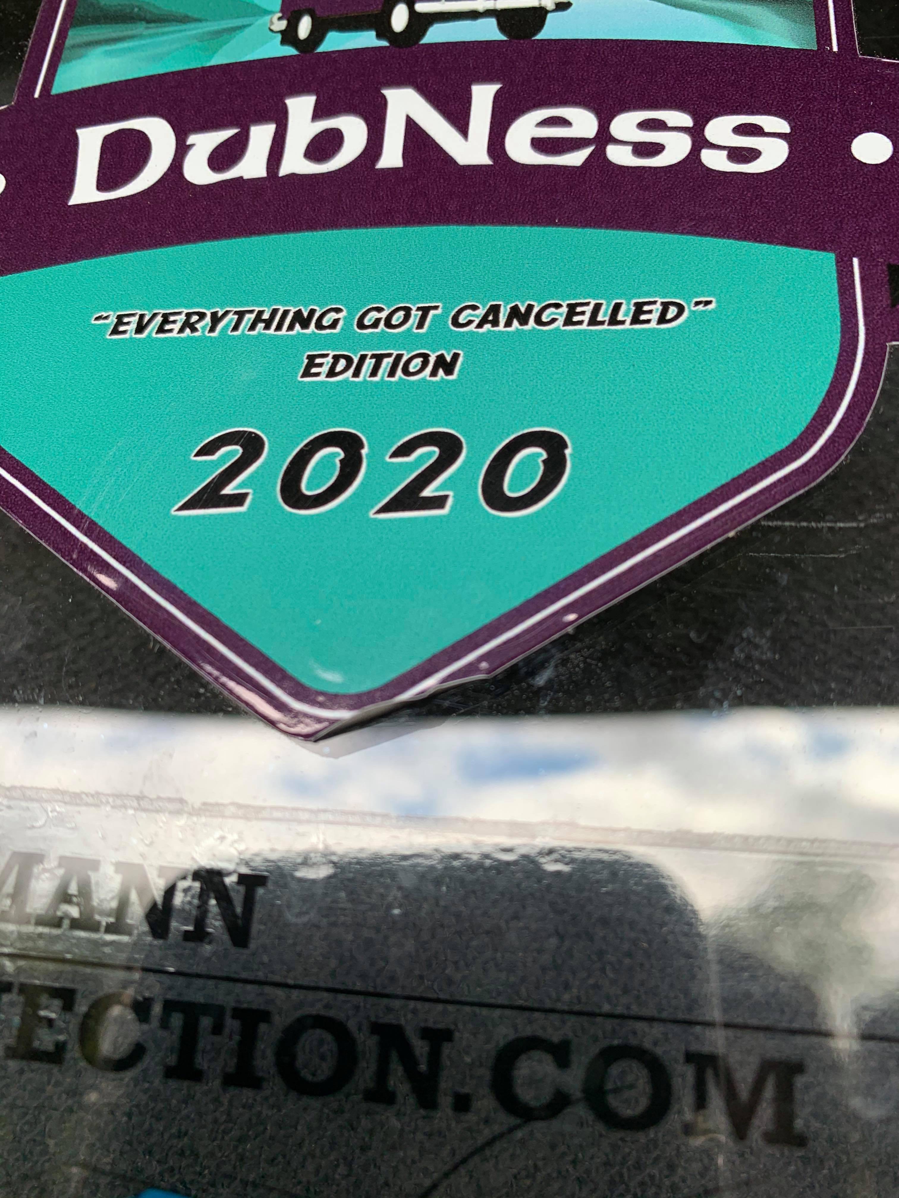

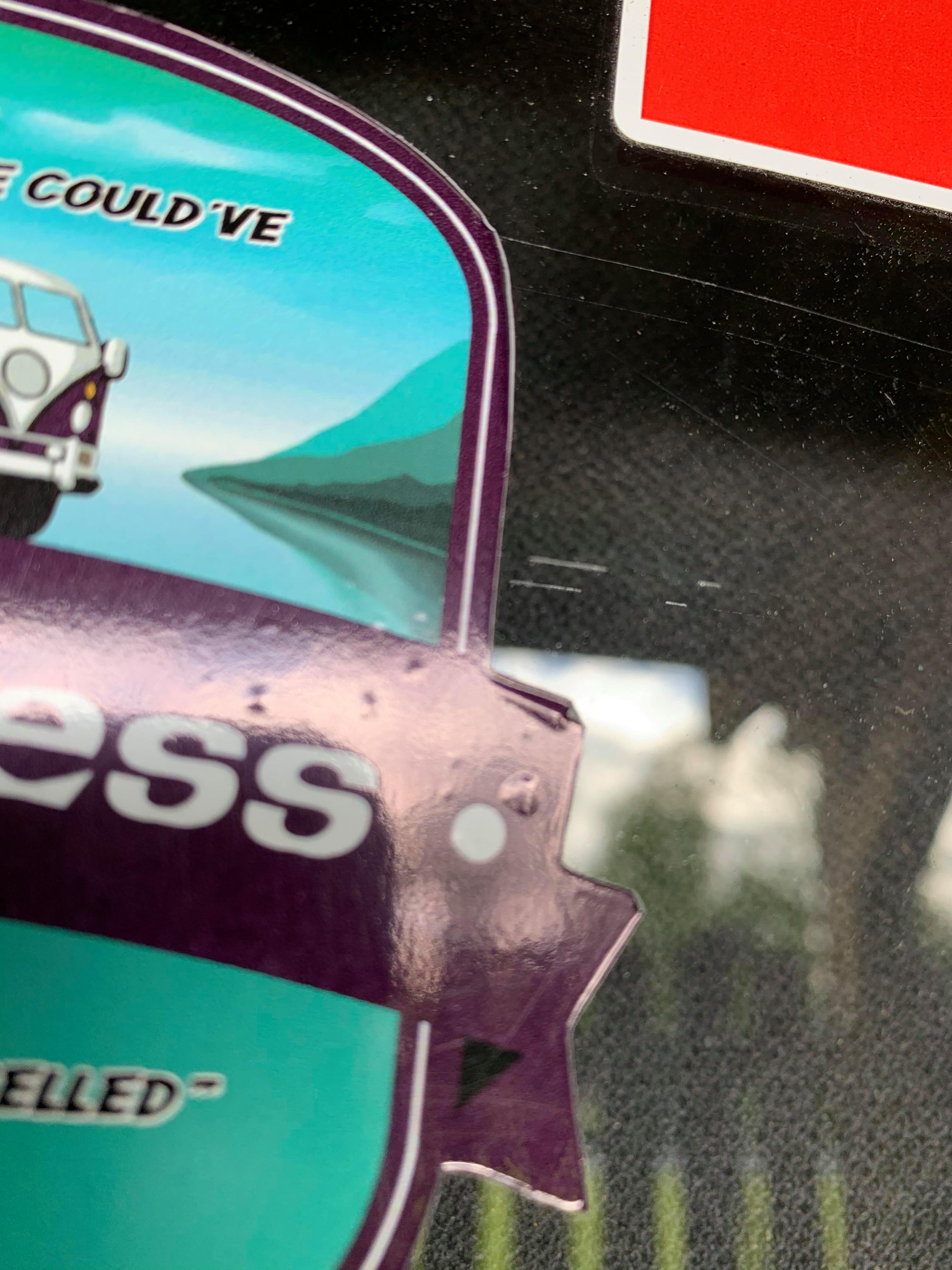

Ok so I am using a media that’s 80 microns thick. i printed some stickers for a customer who put one on her van and sent me these pictures (attached) where they appear to be curling at the edges having only been on the window outside of the window for about 5 days.
An anyone advise me as to why this has happened? If I give the design white border when it prints and cuts donors not cutting through the ink would it still do the same? Or could it be that it’s been applied to a dusty/dirty window?
any advice will be greatly appreciated. Also is it better to print on thinner or thicker media for stickers?

I ran/run a solvent for 6+ years and have never found that you can’t cut through media that’s been printed - what tech are you using?
Honestly with customer installations anything could be a problem here.
definitely looks like the window wasn’t cleaned prior to installation so that’s a big no-no to start off.
aside from that, it’s probably just not been installed correctly, anything from customer getting their fingers on the adhesive to not sealing the edges properly.
For your other question, I’ve always found customers can install the thicker stuff better, but generally the calendared vinyl is thicker than the expensive stuff. So It depends on life expectancies. It definitely makes it easier if they’ve been laminated.

For these types of applications, we have switched to General Formulations 6 mil semi rigid vinyl, it's nice and thick for the client to install and it doesn't curl on the edge when printed full bleed.
The decal in your photo looks to be laminated correct? If so it's not the vinyl curling from the full bleed as laminating fixes that, I'm guessing they cleaned the window by giving it a wipe with their greasy hand before applying the decal with the other greasy hand.

Several things come to mind. As previously mentioned, it looks like the surface wasn't cleaned properly, as I see bumps under the decal.
But most likely the vinyl wasn't allowed to outgas properly. When you are going to contour cut into the design (bleed cut), you MUST allow the ink to fully dry and outgas for 24 hours BEFORE laminating and/or contour cutting. If you don't do this, when you contour cut, the blade will drive the "uncured" ink down into the cut and the solvent that is still in the ink will start to degrade the adhesive at the edges of the cut. Ink needs to dry and outgas, just like paint has to dry completely before handling. The ink may appear to be dry to the touch, but still has solvent in it underneath the dried surface layer. This edge lifting is a common issue when doing bleed cuts without sufficient drying/outgassing time.

did you laminated it??? that happen with contour cut the print without lamination. if you laminate it and contour cut inside the print.... without lamination need a white bleed. that sticker also look have some dirt on it.

White borders do solve the solvent problem. Letting the ink thoroughly dry is necessary. That takes anywhere from a few hours to overnight, depending on which ink set you are using. If you are laminating the vinyl, too much tension on the laminate can also cause the vinyl to pull up.

If you truly believe solvent doesn't need to of gas... Print something and 5 mins later take it off the liner... It'll be gooey. When you put overlam on... That solvent has nowhere to go but the glue - It causes bubbles, or curling.
as for the edges on this photo...
It's customer installed, in my opinion... she didnt push the edges down properly. The #1 thing they teach you in wrapping class...go over the edges, then go over them again... and again until you're sure you've done it properly. All it takes is a tiny spot thats pressed down and water or wind will get in and it'll peel. Seeing as how much dirt made it under the decal, I'm going to guess they just slapped the sticker on and didn't ensure the edges were good.

All of us have printed and not waited to laminate at some point in time. If it was so sensitive, youd see a lot more failures.
My bet is that it’s either real cheap vinyl with poor adhesion thats shrinking in the sun or the window wasn’t clean.

I learned day one printing stickers and cutting right away gives you edge curl once the ink starts to dry and shrink it pulls up the edges up just like that.
Run a test print and cut right away then let it dry you get curl and then print one and let dry overnight then cut, no curl.

Needs to dry/outgas longer.
Use a white border (no bleeds) to avoid curling entirely. You and customer will both be happy. Plus, on dark glass, the white border will help the decal stand out.
