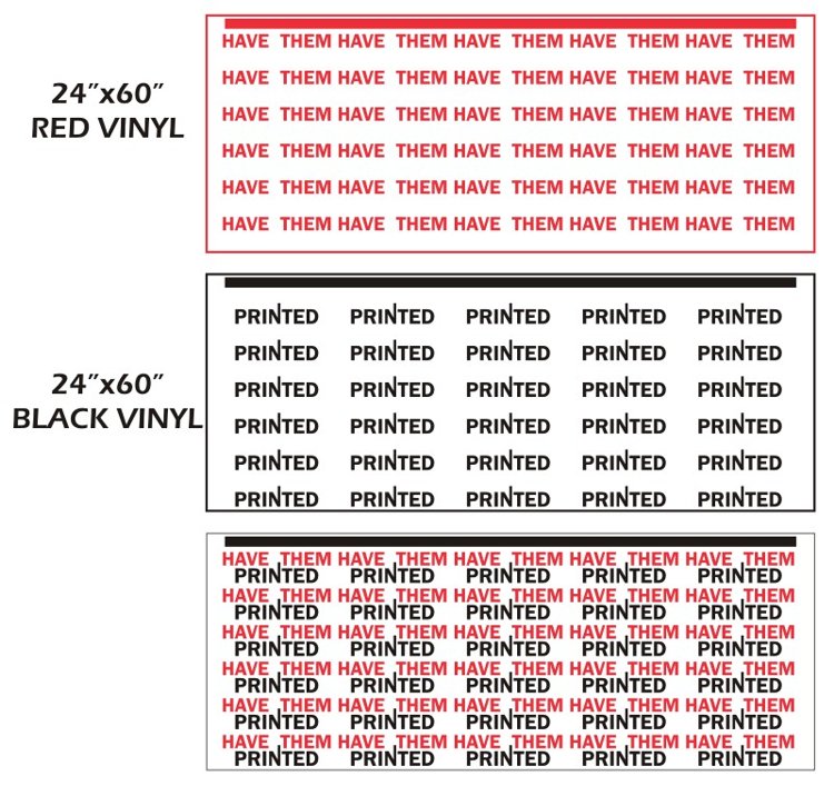

Take a look at the pic I attached.
The top piece represents a 24"x60" sheet of red vinyl. Note the .5"x55" red rectangle that has been cut out across the top.
The middle piece represents a 24"x60" sheet of black vinyl. Note the .5"x55" black rectangle that has been cut out across the top.
These show how they will look after you weed them out.
1 - apply transfer tape to the sheet with the black vinyl.
2 - tape the red vinyl sheet to your worktable. Do not apply transfer tape to this piece.
3 - place black vinyl sheet on top of red sheet, aligning it so that the black rectangle is exactly on top of the red rectangle.
4 - attach a masking tape hinge to one of the long sides of the black vinyl sheet.
5 - flip black sheet over on hinge, remove transfer tape and apply to the red vinyl sheet.
The bottom piece in my pic is how it will appear when finished.

The problem with doing one like like that is you then only have two reference points (the ends) to line them up. doing so when you are new that is more of a chance for them to stick it wrong and have their only reference point pull up. thus why i suggest registration marks, i use signcut and they have boxes turned up on the corner, i usually do one every 6 inches no less than 3 on the top and it helps lining up when new at it.

You can always use clear transfer tape you can see what you are doing better. I do this when I do decals cause it makes it easier for them to install when they dont know what they are doing

This is how I would do it. I also use a glass covered table with a light underneath to better see the alignment. I have done decals that required 4+ colors. As long as the bottom layer is immovable, there shouldn't be any problems.
And if the text is anything like what B Snyder posted, there isn't any reason it couldn't be done in 2 hours.

Snyders is the way we would do it. It's the way we do it when the colours are not matchable with print or they require a 2ml vinyl.

GREAT explanation and illustration!
fastcut
quote]
What kind of tape do you use to tape down the bottom layer...I haven't found any that sticks to the backing, therefore movement is always a possibility. I go diagnal in the corners and go over them again in the opposite direction...but just wander what you do?
