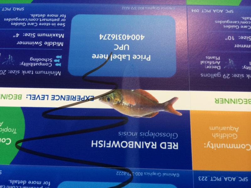

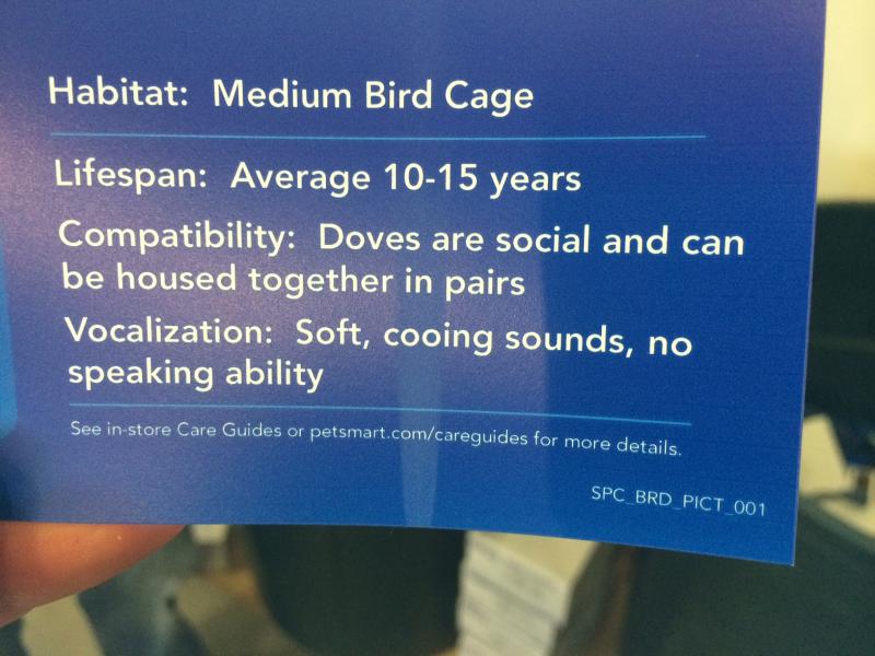

We have been getting these drips and they seem to be getting worse. It looks like its from the cleaning solution, but I'm not sure. I guess it could be the media, but I doubt it. Printing on .010 rigid vinyl. Any thoughts?

I have seen this happen when the rail is greased too much causing it to drip on to the vinyl. Also, it could just be the material or how you are storing it. Check for leaks near your storage area.

Looks like your heat settings may be to high causing slight buckling / lifting in the material.
Those slightly raised areas will print lighter.

Thanks for the suggestions, I will check on the rail and the heat of the printer. Storage area is all good though, so I don't believe that to be an issue.
