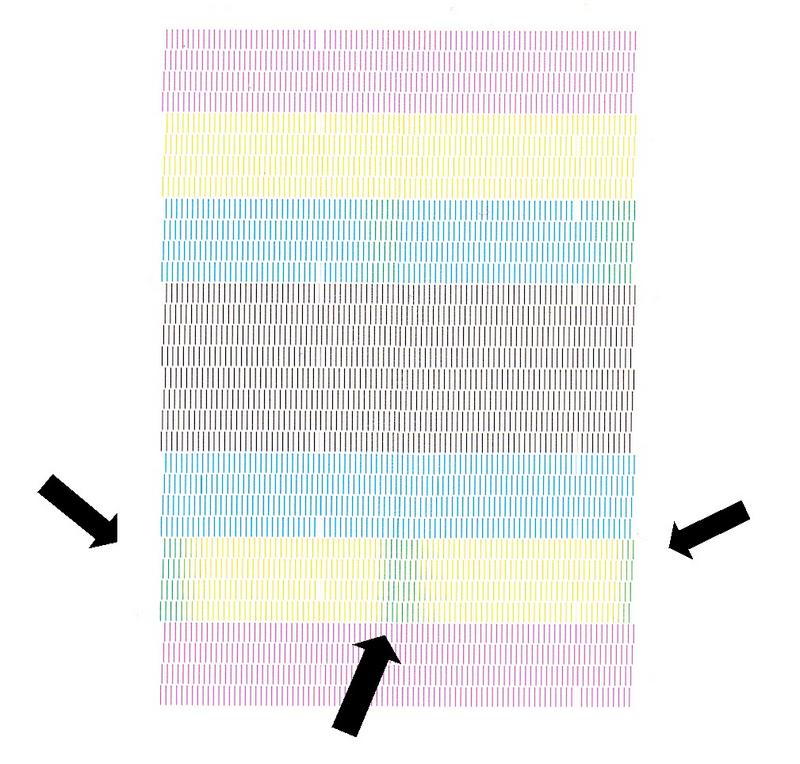

Anyone have a test print with multiple colors in a strip?
Cyan is in front and rear of one of the yellow test patterns. In the morning before a cleaning, the one yellow is completely green in one of the yellow tests.
First thought was the head. Now possibly thinking it may the the manifold between the dampers and the head.
Anyone ever have to replace a manifold?
Any thoughts?

I hope it's not the same issue for you, but this happened on our VS-540 with black bleeding into the yellow.
Ended up needing a new head :(
reQ
Cap tops not installed correctly and don't make right contact with print heads. Had same issue when i was changing mines. Adjusted them and its all good.
Steve Prince
I Like the cap top idea over the head and will look into adjusting it first.

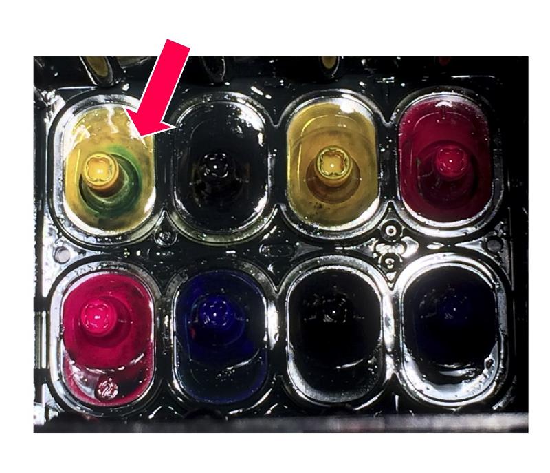

I did dig into it a bit deeper and wondering if this picture tells anything more. The test print looked the same before and after I changed the cap top and dampers though, so I'm wondering if it could be a cracked manifold.

O-Ring/Gasket
You have a damper issue.
If you look carefully at the nipple with the arrow, you will see that the o-ring/gasket from the damper. It was pulled out of the damper. You are simply not getting a good seal.
Look at the bottom of your damper and you will see (most likely) that the o-ring gasket is missing.
If you don't have a replacement damper, you may be able to remove the o-ring/gasket from the nipple and re-insert it into the damper. It's pretty easy to do on these types of dampers just as long as the gasket is not damaged.
You should consider replacing the damper as soon as possible. Please remember to use the ink choke when replacing the dampers, and cover the head with some towels to catch any ink drops.
Good luck.
~E
