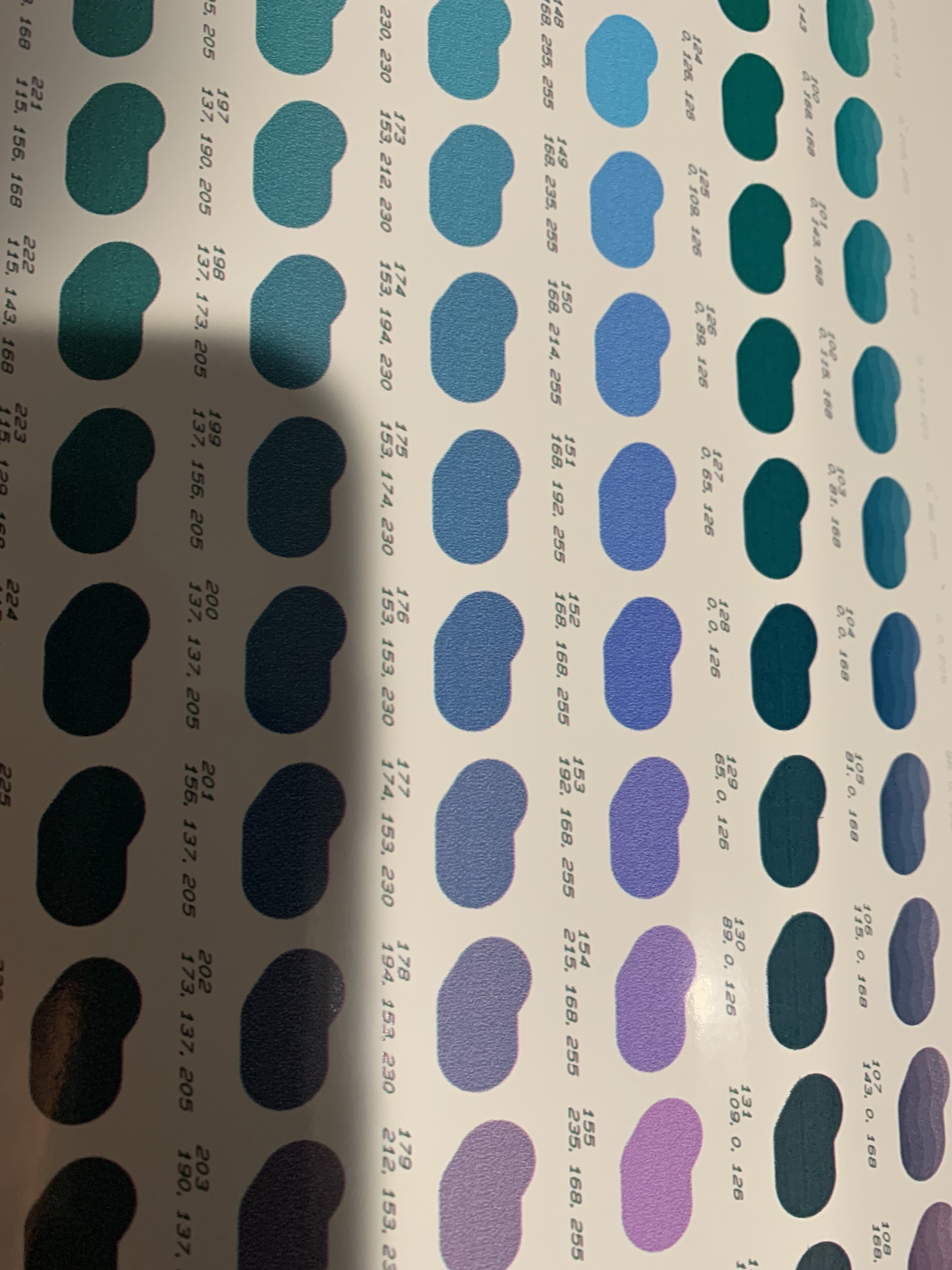

midnightmadman
If you look at this nozzle check you can see the colors are overlapping in spots

Zoogee World
Domed Promotional Product Supplier
Sounds like interference. You might want to check all the connections. Either something is loose and making a poor connections, damaged or a board might be on the way out.

Thanks. Last time I pulled the head cables out and put them back it it seemed to fix it. But why would shutting it down fix it this time ??
Is there a possible electric issue with the actual outlet. Maybe grounding or stray current ?

I'm not familiar with this particular printer, so I cannot say for sure. But it does sound like either electrical interference of some sort or a board is going bad. Restarting might help it because you are cutting the power for a moment and resetting it and once you get going, whatever the cause is builds up again and causes your problems. Might be time to change the cables and see, as they would be cheaper then the boards.
rjssigns
Might want to replace those ribbon cables also, might have a little kink in them somewhere.
This ^^^^^
Ribbon cables are a consumable. The wire in them is finer than hair and they can only take so many bend cycles. I replaced them on my Roland when I started having print issues. Problem solved. At some point I know I will have to do the same on my new printer.
