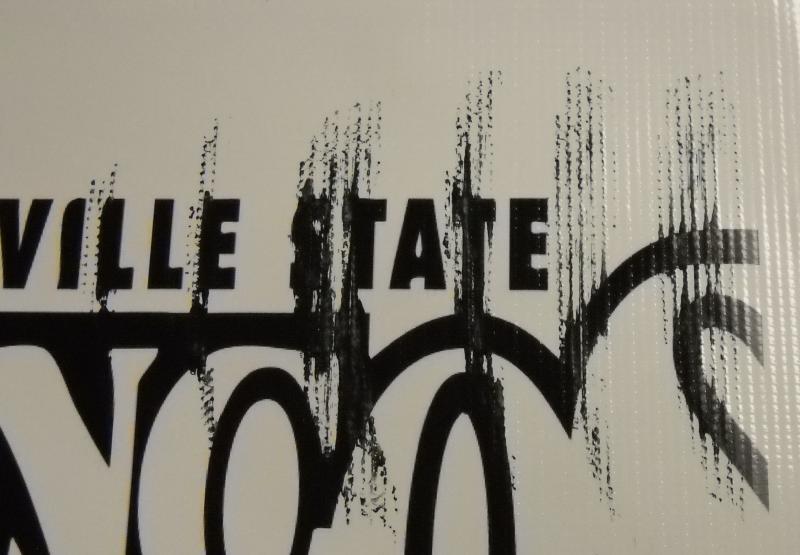

I have a Mutoh VJ 1204 Printer. I've had it for about a 1 1/2 months. Everything is working out great except for one thing. When I print banners there are streaks (looks like ink has smugged). I've changed the settings to a banner. Everything works great with other materials. Any suggestions?

File attached

HaroldDesign
OH okay, that's a headstrike. Not a different potential issue I was thinking it may be. Take Randya's advice on all things Mutoh.
tsgstl
dont worry about the heat
get a profile for that material or something similar and raise the head
adjusting heat settings is the last resort
also be careful with the hairs or threads on some banner material, if you get it cut burn of the threads with a torch or some alcohol and a lighter. those things will stick to your wet head like white on rice causing all sorts of issues
randya
Heater options are in the "Printer Options" menu in Flexi.
I normally run 35 prehead, 38 platen, 50 dry.
The orange lever on the head carriage will set the head height.
jtiii
I paid good money for you to read this!
I bet this is the problem!
with our roland i always unwind the banner at the back so its not tugging on the banner any, as banner tends to be heavy.
We used to get those same streaks. We could see ripples forming on the banner but couldn't figure out why. It took me forever (since I was too dumb to ask at signs101:doh: ) to figure it out. It turned out that with a heavy roll, or a roll that had a lot of cling (like two sided banner material) we just need to keep some slack back there and we now have no problems with it.
