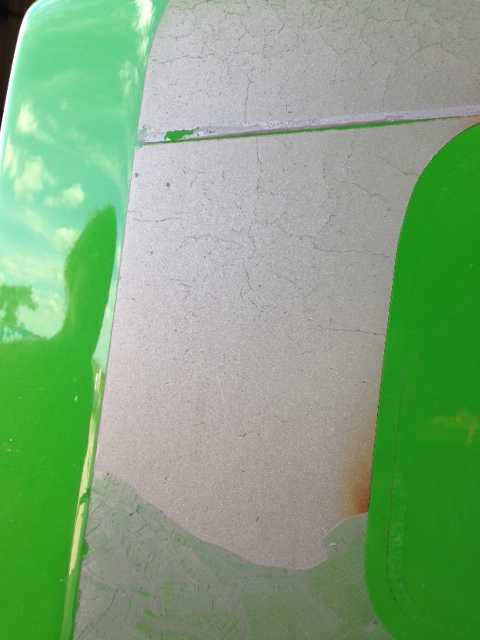

Hi everyone. We are replacing some striping on a semi and running into issues with stripping the existing vinyl. It is metallic and very old. Any tips? We have tried heating it up, using RapidRemover, scraping it and at this rate just the hood is going to take at least 3 hours...too long! Any help is appreciated. Thank you!

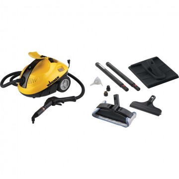

With all the talk about steamers, I gave in last year and got one. Wagner 915. j-915.jpg About $100.00 or so. It's alright, but it runs out of water about every 20 minutes, then you have to let it cool down. It only works in sections at a time according to the directions, and when we experimented, it didn't do squat. So, for something small, it might be Okay, but I'm still sold on the Zapper.

With all the talk about steamers, I gave in last year and got one. Wagner 915. View attachment 92701 About $100.00 or so. It's alright, but it runs out of water about every 20 minutes, then you have to let it cool down. It only works in sections at a time according to the directions, and when we experimented, it didn't do squat. So, for something small, it might be Okay, but I'm still sold on the Zapper.
http://www.lowes.com/pd_40627-97-0282018_0__?productId=3033147
This one. it has a pretty big tank. Runs for over an hour before we have to refill it..... pretty dang cheap too.

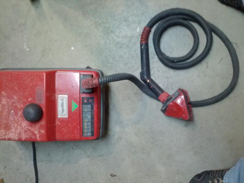

been stripping semi trailers and beer trucks for years and the steamer works real well we use a vaper blitz.Can strip whole side of beer truck before refilling
