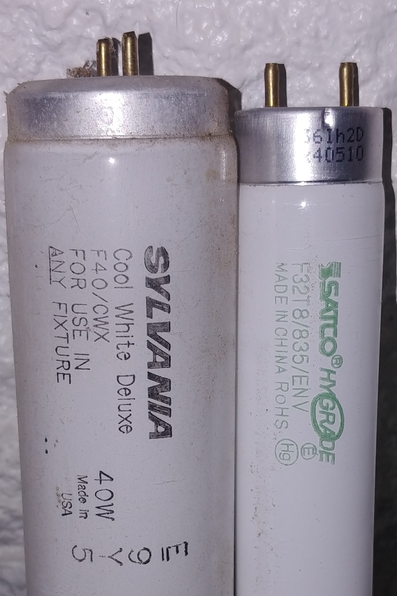

This isn't for a sign, it's ceiling lights in my pantry...
I have to replace some bulbs and I have a bunch that fit and light up but are thinner, would that be a safety issue?
Andy D
bannertime
The larger ones are 40w and the smaller ones 32w. Should be fine*, but not as bright.
**unprofessional advice and do not claim to be an electrician.**

T8's will light up in a T12 system but the ballast is different from what they are designed for (because T8's produce light a different way than T12's, using internal electronics rather than electromagnetic induction). The T8 is more efficient if used with the right ballast. If you use a T12 ballast, you will not gain the efficiency and you will overdrive the bulbs, reducing life.
Andy D
Thanks to everyone for your responses. It has been on my "Honey-do-list" for way too long and my wife was fussing.
As long as it's not a fire hazard, I'm good, we don't use that room enough to worry about it too much.
