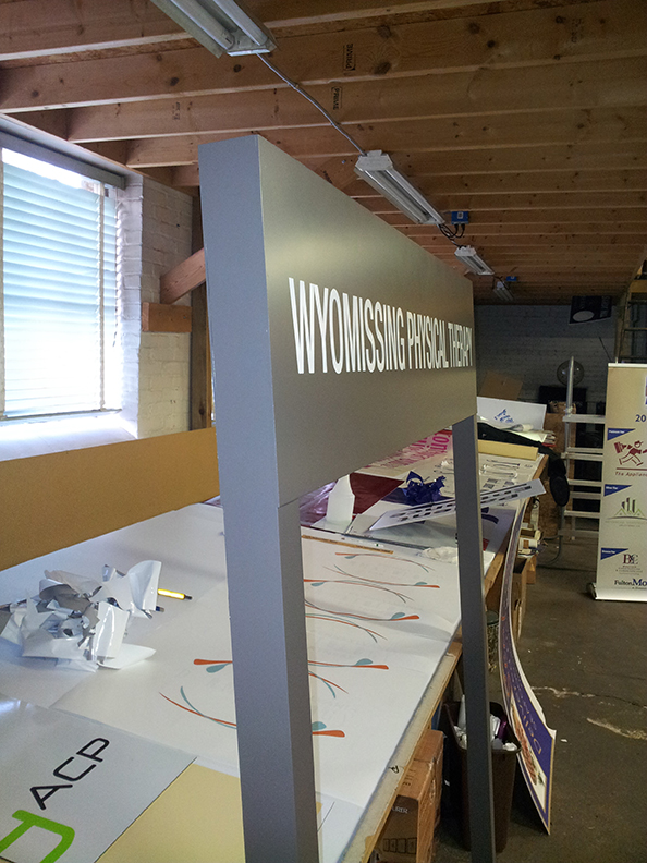

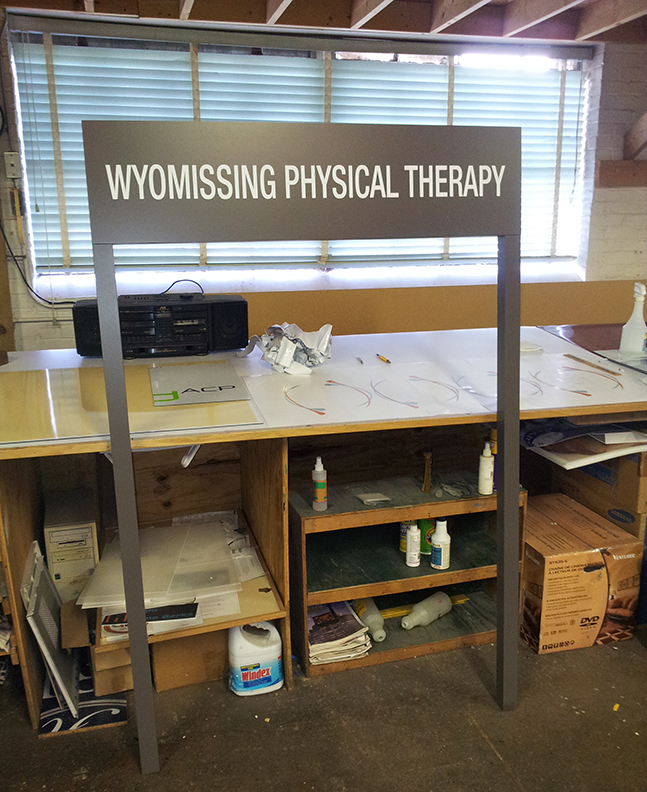

    Just finished this yesterday. 2" square legs with top & bottom cross pieces (stringers) the same. Welded on 12" x 48" x .080 face front and back. All mill finish is cleaned properly, primed and 2 top coats. Finished sign.... no installation needed..... $ 980.00

    How to do you weld the faces to the frame on a double sided sign like this? Do you do the sides then sand down flush and paint?
