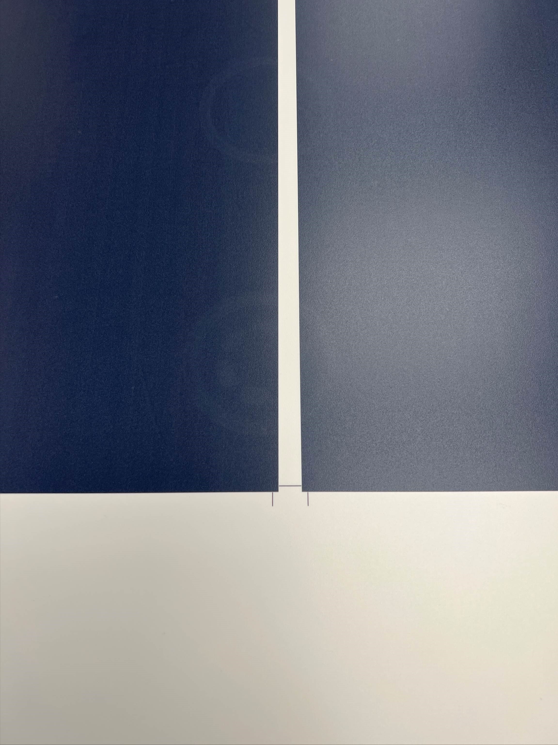

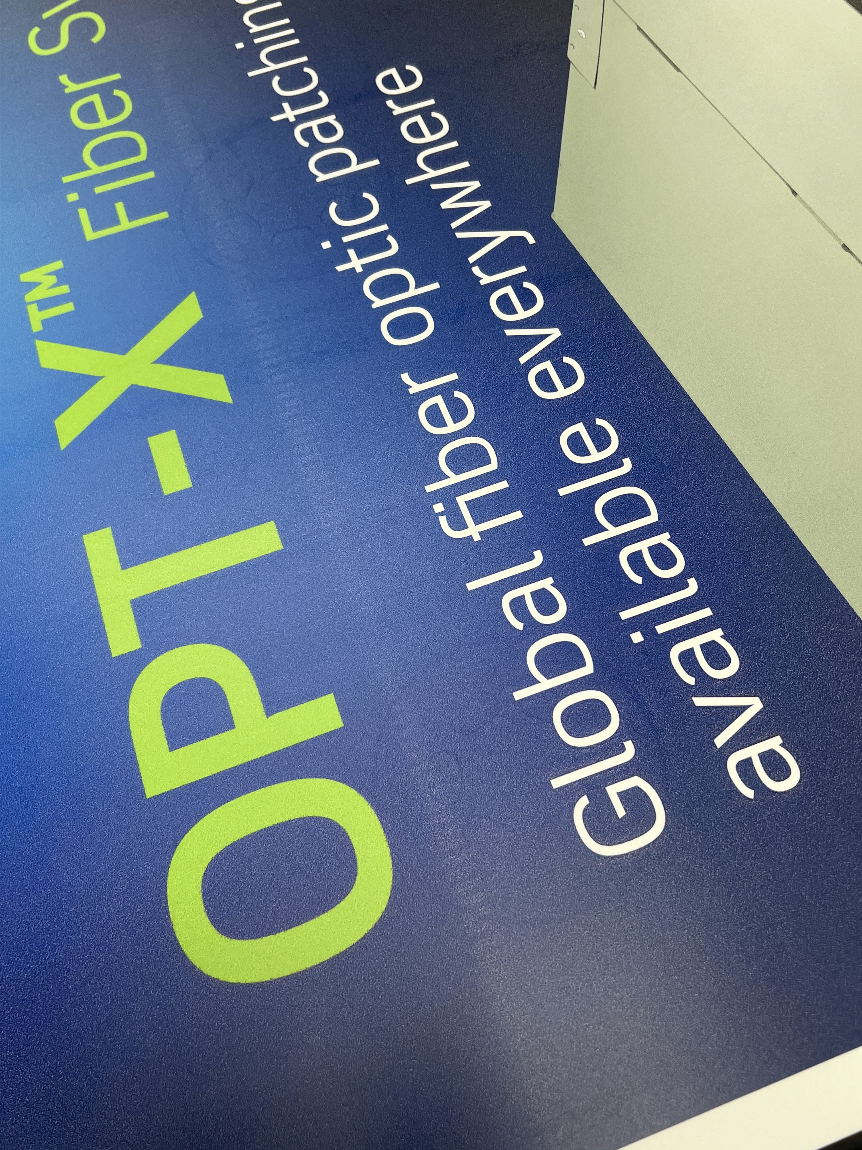

We have had an ongoing problem with fresh boards of Sintra, expanded PVC, PALIGHT, arriving with invsible suction cup marks that reveal themsevles when printed over. We can't see them before printing, but they ruin the print. We can flood print white underneath to hide them, at the expense of slower printing and higher ink cost.
Surely we're not alone in this. What feedback does the group have around this issue?

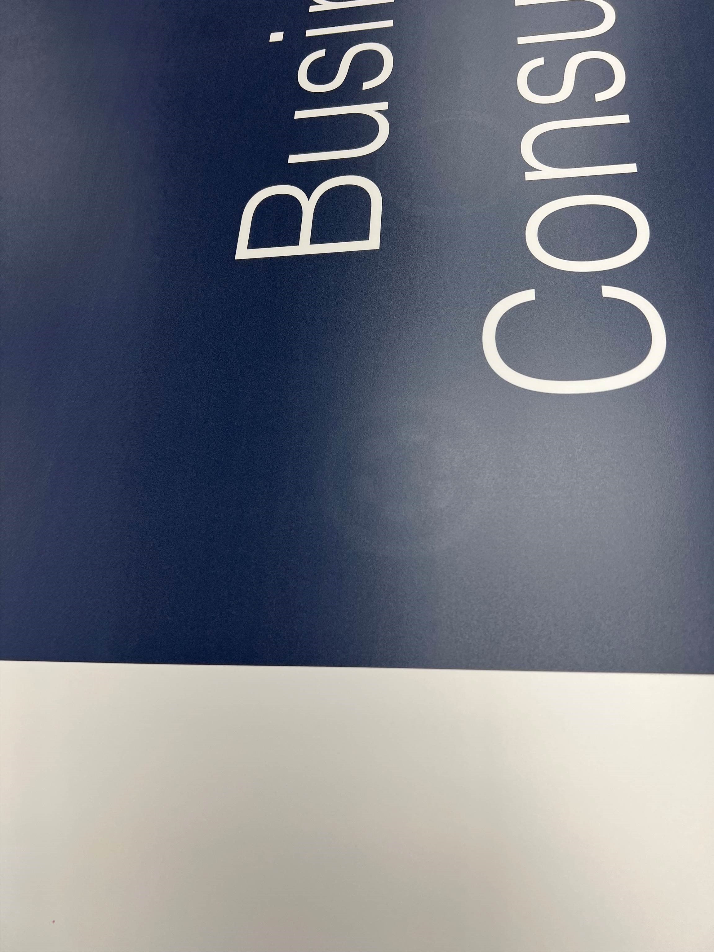

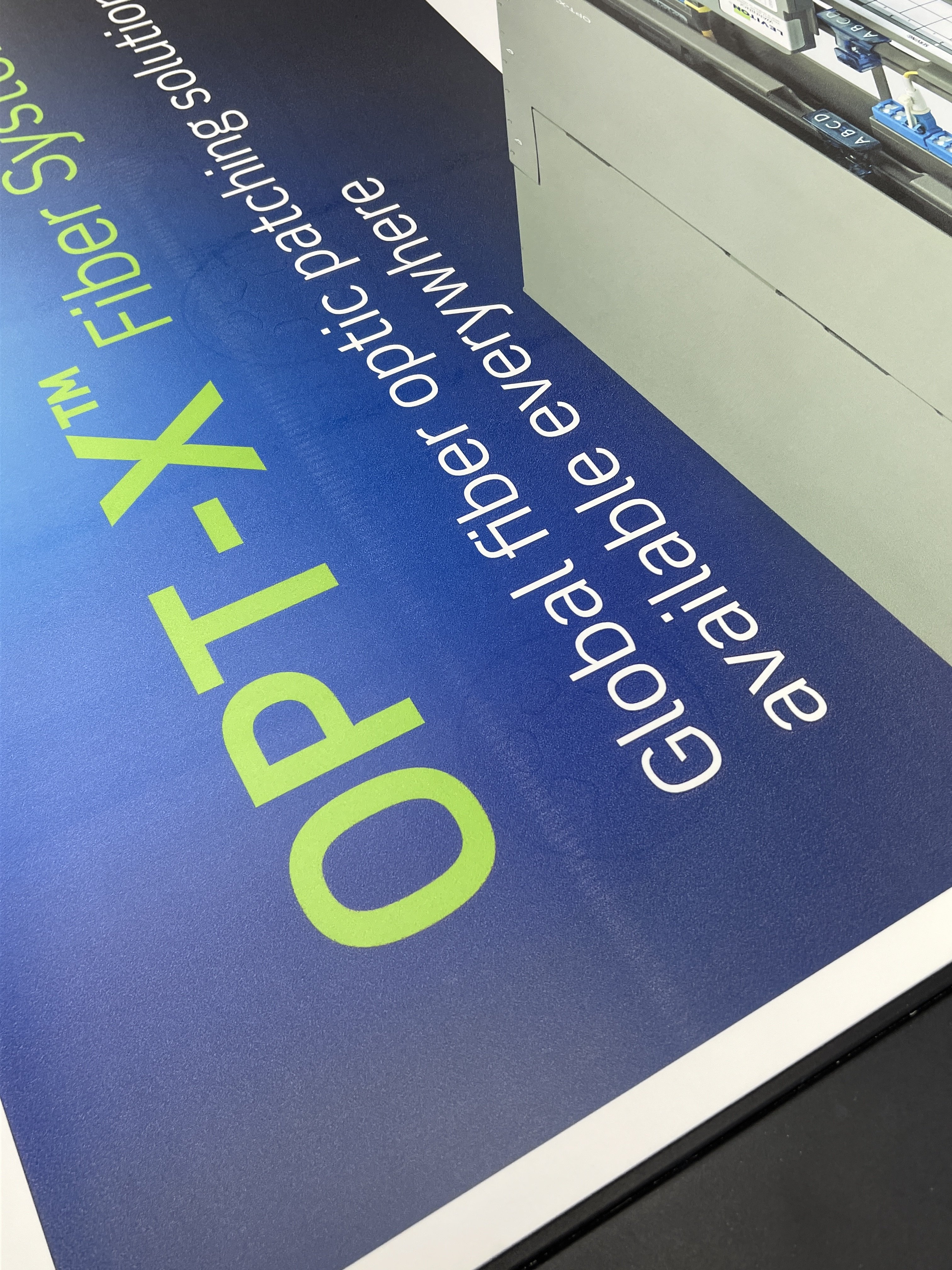

Here are examples of other deliveries of board with similar issues. These look like suction cups used to move the boards around or stack them on pallets.
