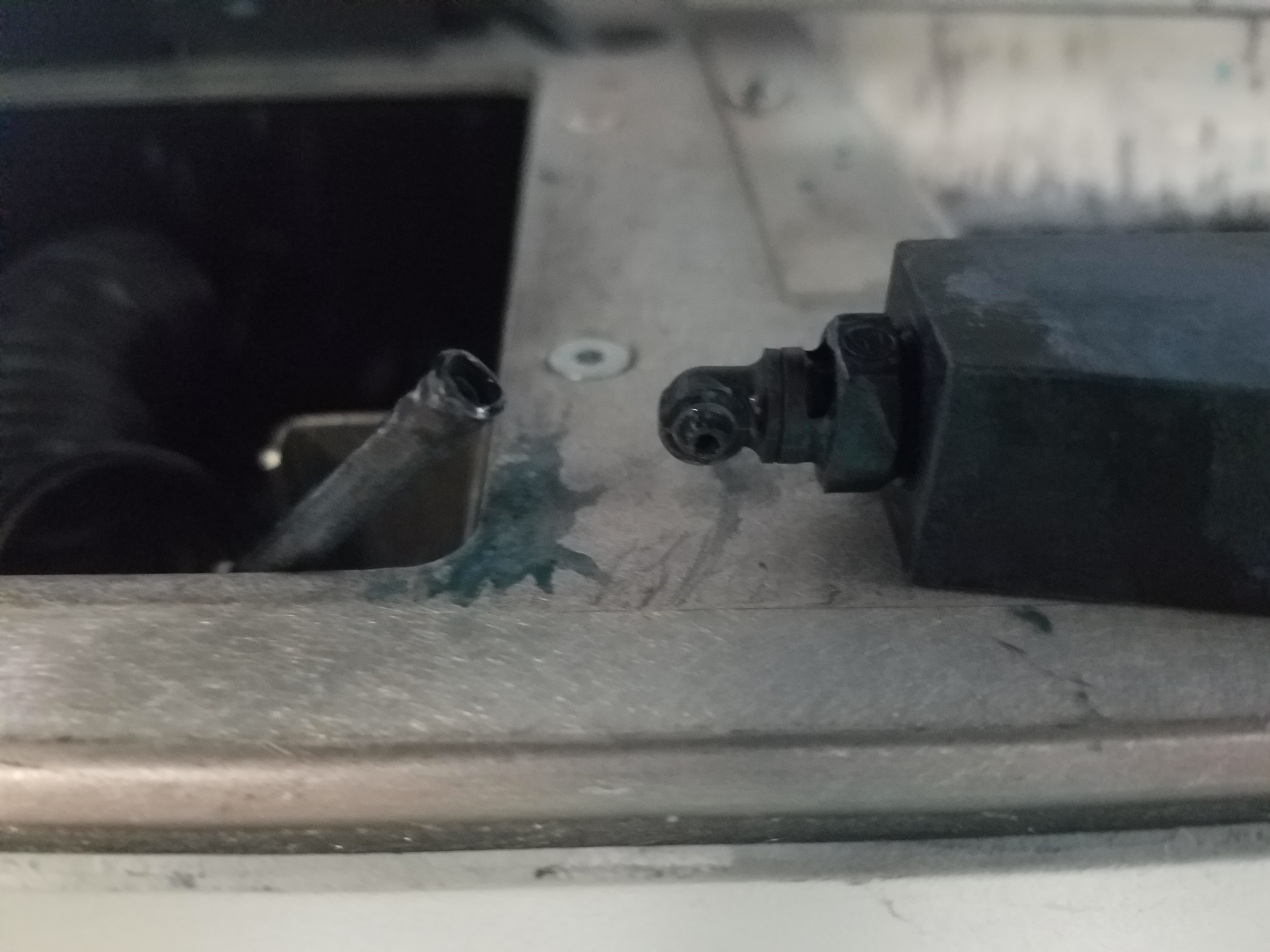

Does anyone know where I can get the connector barbs for the suction pump that White Haus mentioned? Mine snapped off yesterday. If I have to get it through Canon does anyone know the part number?
Thank you!
Thank you!
Hey Dale, sent you a PM but here it is in case anyone else needs it:
We do order our parts direct from Canon (Canada) but here is what I have listed for that part:
Part number/item number: 3010105366
Description: FTG-ELB SWIV 3/32 BARB 1/8 NPT
