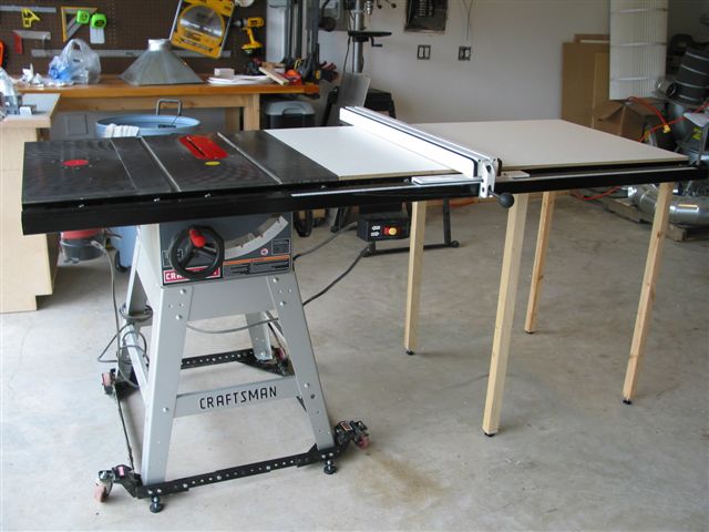

Wow... more I read about these "substrate cutters", the more I just want to keep using my table saw.
I have about $600 in my saw with extension table and nicer/longer fence. And that was about 10 years ago. (pic from back then)
