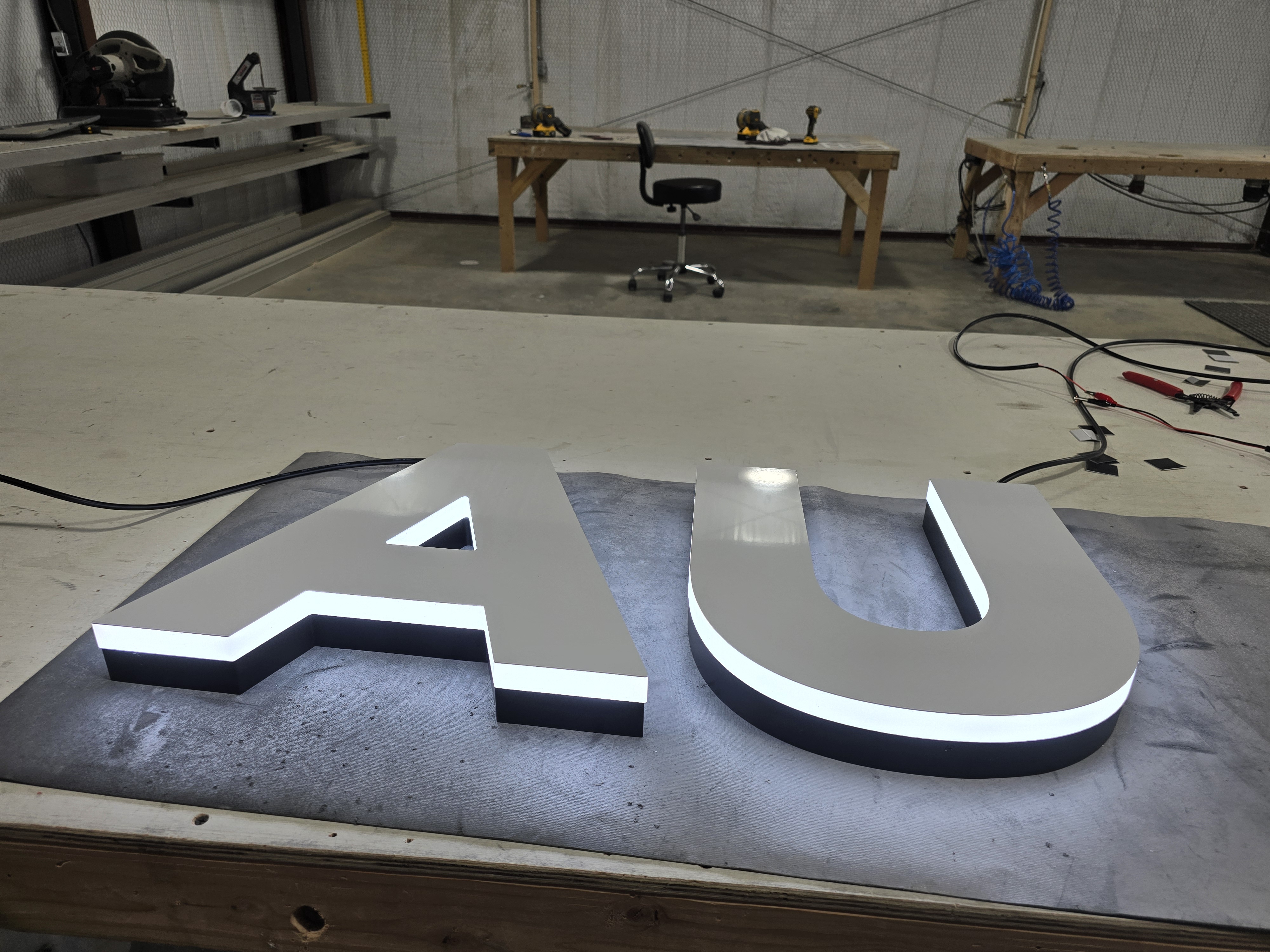

I'm looking for suggestions on the best way to get an opaque face for a trimless channel letter that will have 1" acrylic face (maybe 7/8" reveal) that is edge lit with the face being opaque and white. I've done this in the past using white blockout vinyl that has a black back side. I wasn't very happy with the way it looked during the daytime because the acrylic looks dark when not lit (see photos in links below of "DQ" sign). This might be due to the 2447 acrylic which is milky white and might be due to the fact that the inside of the vinyl is black or that inside of the letter is dark. My new plan is to apply white vinyl first and then the blockout white vinyl over top of the white vinyl but I'm not sure if anyone has a better suggestion. The client has requested 2447 milky white 1" for the acyrlic and the channel let part will be just 1 in deep.

I'm not sure there is a way to get the edge of 2447 to not look dark when it is not illuminated. I agree that the black back of that film is just making it worse. Does light up nice though! Only option I would consider would be to apply painted aluminum faces to the front of the acrylic. We do that for alot of push thru letters when the customer just wants edge lighting.

Prepainted .020 white aluminum, mounted with 3m 467mp or other double stick sheeting. It'll leave a damned fine silver edge, but I can't imagine it being unacceptable. I'd opt to mount the whole sheet of .020 to the acrylic before cutting it, it probably wouldn't even alter your method, as 020 is slightly thicker than the facestock on some decent acm.

They want 2447 so it looks best at night and we are going to do an aluminum skin on face that will be prepainted white. I will post pics when done. Thanks for everyone's suggestions!

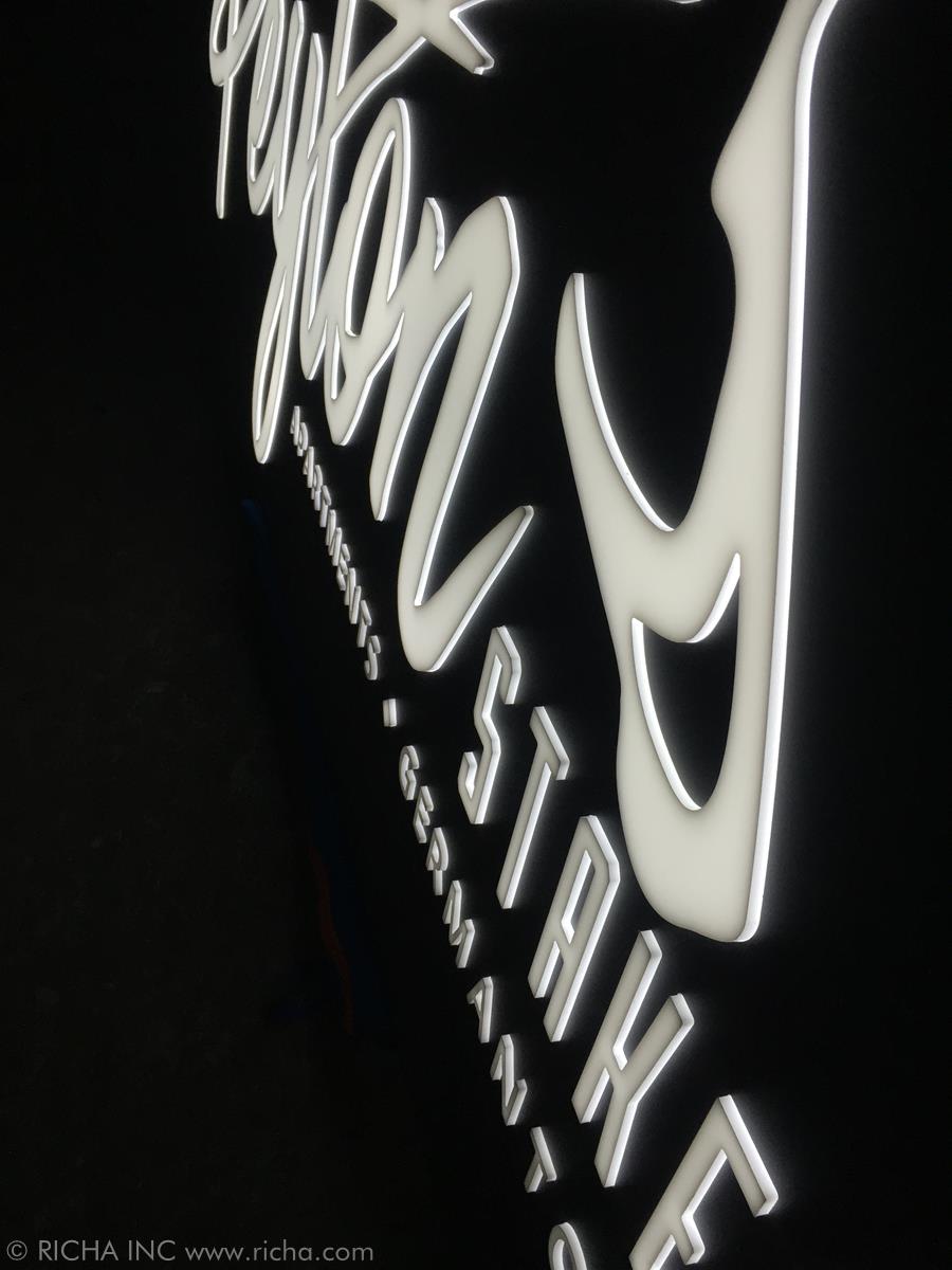

Yeah that's honestly why I'm curious - we use 7328 universally but we do have some light drop off on the front edges for push-through (though that might be unavoidable)

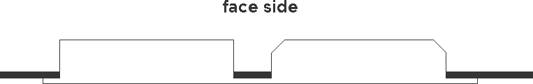

I opt for clear acrylic, with a white poly backer. It gives very uniform light distribution, the while poly acting as a diffuser and the clear just giving an impression of depth. The downside is that the letters are clear, so the depth at a persective isn't preserved as well as white acrylic, plus the added cost of the polycarbonate.
If you wanted to stick with the 7328, add a chamfer with a V bit. It will reduce the distance the light has to travel to reach those 'corners' of the push through letters (when viewed from a profile).

We have done domed/rounded push-though white to get a faux neon look before but those are expensive due to extra CNC time, never considered the chamfer but that's not a bad idea (doubt I could get a client to pay for the added time on an issue that only really bugs me)
