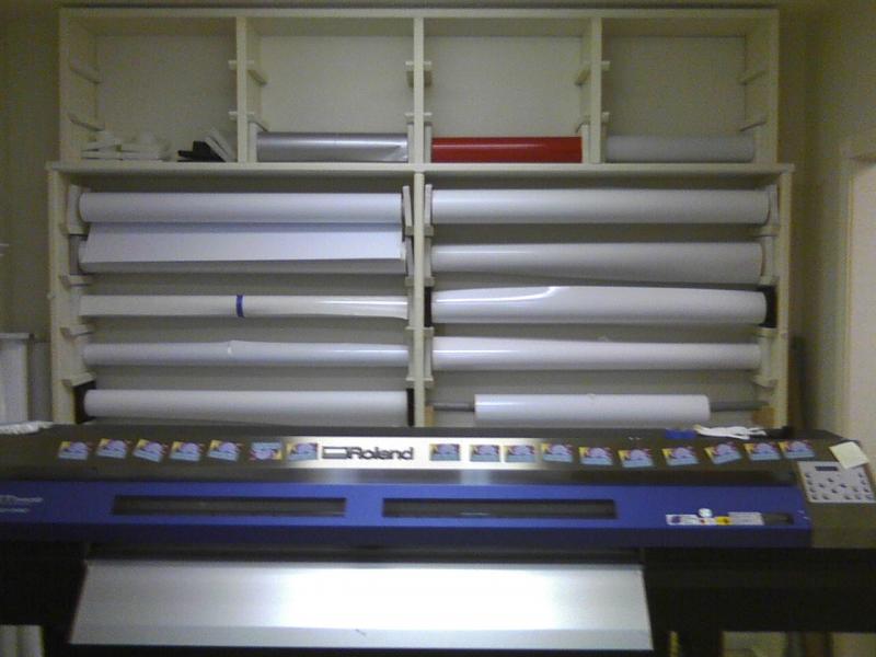

here is a rack that we built that uses the plastic ends the rolls are shipped in.

Thank you ucmj22 for a relevant reply.
I'm just trying to think of how to do something similar to accomodate the varying widths from 48-60"... Possibly the same just the ends sit on shelves?

NP. its just 2X12's for the frame and 2X2's cut for the "shelves". we routed the edges of the 2X12's to make it look pretty, and used L brackets to mount it to the wall.
