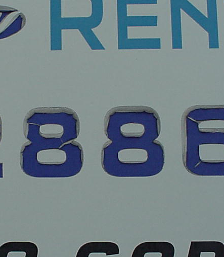

Good evening all! I wanted to get your input on a tricky situation we have found ourselves in. We install lettering for a local company that manufactures a specialized box truck. They sell these trucks to companies all over the country. They sent me pictures the other day of a truck I lettered 2 years ago that is over a 1000 miles away. The install consisted of three colors which are all Oracal 751. Two of the colors look as good as the day we installed them. The third color, King Blue, looks like some of the pics on here of Avery vinyl. It is falling off of the truck. We do about 10-15k a year with the local company and need to make this right. What would you do?
Any input would be greatly appreciated.
Thanks.

Thanks everyone. We had already told our client that we were planning on travelling to New England to redo the lettering. They acted like we were crazy which got me wondering whether we were. Your input has made it clear what we should do. I have used Oracal 751 for ten years and never had a single problem so I don't hold this against them. I may go the 3m route though just to appease the end user. I uploaded one photo that captures the problem- i just hope I did it right.
You guys are the best.
Buckeye deSigns

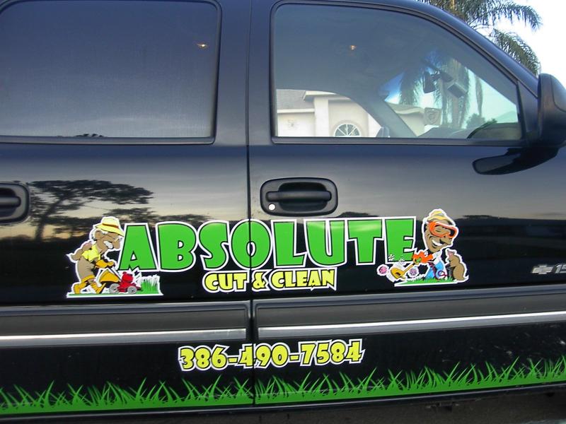

signgirl71
Oracal is what I keep on my shelf, both regular vinyl and digital and it is because they stand behind their product. A few years ago I did a job before we had a printer. It is all layered vinyl. We had a problem with the yellow fading. Oracal stepped right up and with no hassles what-so-ever gave us a credit for EVERY color we used on this truck even though it was only the yellow that faded. That credit was more than enough to cover the removal and replacement on the truck. The Oracal rep was great to deal with and the only thing that took some time was getting the rep to believe we didn't have a printer and that this was all layered vinyl. =) Because of that great service I will continue to use them and recommend them all the time. This is a pic of all the colors they replaced.
