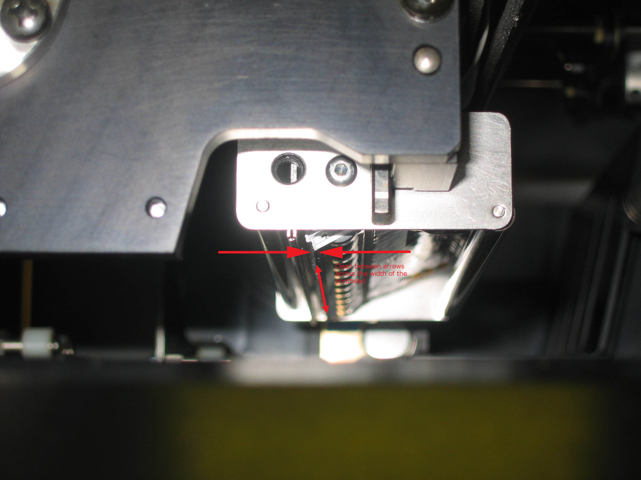

Hi Brian,
I wanted to let you know that it is definitely possible to clean the printhead on your DC5. You will need a lint free isopropyl alcohol swab to clean the head and you want to clean it from the front to the back of the printhead. I have attached a pdf document which shows the side of the printhead you will need to clean. Once you complete the cleaning I would also change the cleaning sheet on your optiprint cleaning system and try running a few prints of solid colors that run full span. For example, if you are printing on a 54" wide media your printable area per pass will be 3.79" tall by 50.2" wide so just design a rectangle roughly that size and print a few passes. If the white line is still present in the middle of the print pass after the cleaning then unfortunately the head would need to be replaced.
Please feel free to email me directly at philj@airmark.com if you would like to pick my brain at all on this process.
Thanks, Brian!
Best regards,
Phil Johnson
Airmark Corporation
(800)527-7778, ext 112
philj@airmark.com
